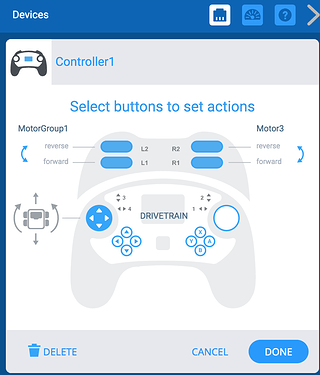

We have our motors connected to our robot by selecting motor groups and assigning buttons on the controller for each group (all in the top right corner of the screen). We are in the block code mode but we don’t have any code there right now so I don’t think that should make a difference.
For some reason all of our motors are moving really slow (like 25% the speed I remember them going last year). A couple days ago there was some kind of glitch I guess because for a few seconds the motors actually went full speed so I know the motors are capable of it (I also switched out motors in case they were burned out but it made no difference).

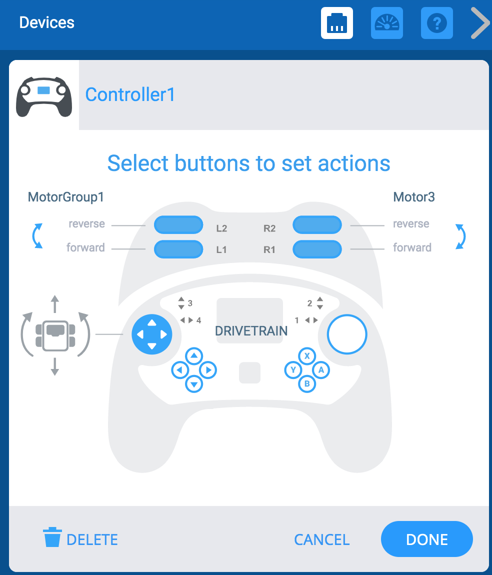

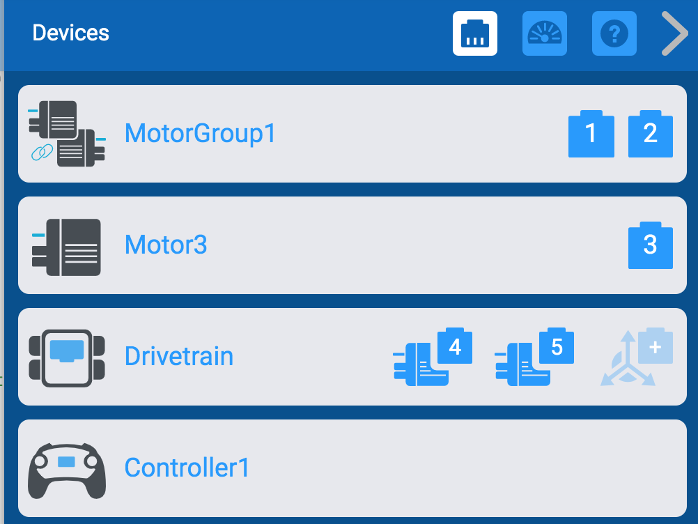

Ok, lets look at an example, this is very easy to test.
I created the following graphical configuration
One motor, one motor_group and a two motor drivetrain.
Lets look at (some of) the code it generates.

you can see the motor and motor_group code is only using Motor.spin(forward), Motor.spin(reverse) and Motor.stop(). This means that they will both use the default velocity for motors which, as I said, is 50 rpm. If these motors have green gears then they will be running at 25% of their maximum free speeds (ie. 25% of 200rpm).
You can change this by adding setVelocity commands at the beginning of the code. I was using a C++ project, so that could be (block would be essentially the same).
int main() {
    Motor3.setVelocity( 100, percent );
    MotorGroup1.setVelocity( 100, percent );
easy.
