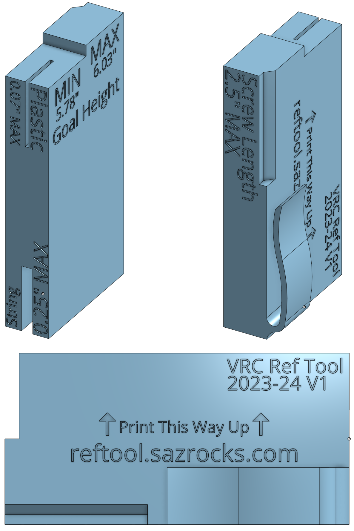

As a referee here in AZ, I’ve often wanted one tool that could do things like measure field tolerances, plastic thickness, etc. Therefore I created the VRC Ref Tool V1 for VRC Over Under!
You can access the STL file here:
https://www.printables.com/model/596409-vex-robotics-competition-ref-tool-2023-2024-over-u
With it referees can measure:
  • The height of the horizontal goal bars to ensure they are above the minimum specification (5.78") and below the maximum specification (6.03")
  • The thickness of plastic on robots to ensure it is within the legal thickness (max 0.07")
  • The thickness of string/rope on robots to ensure it is within the legal thickness (max 0.25")
  • The length of screws to ensure they are within the legal length (max 2.5")
It also comes with a handy belt hook so you can carry it around easily.
The slots for polycarbonate and string are both oversized by a small amount (0.01") to account for inaccuracy while printing. Assuming you print it in the recommended orientation, these should allow any legal width object to fit. Still, you should verify that these slots do indeed have the correct dimensions yourself after printing.
Printing Instructions:
The orientation that the tool is printed has an effect on the accuracy of the measurements, therefore you should print this such that the text that says “Print this way up” on the back is oriented normally, and that the arrows are pointing upwards.

Hello, I have a few questions about this print, but before I ask anything I just wanted to say that you did a great job.
  1. Does this need any supports (Such as for the text, or does that not show up on the print?)
  2. What is the recommended infill for this?
  3. Does it need a special material other than PLA for the clip to work?
    Hopefully you are able to answer my questions, but otherwise thank you for giving this resource to the Vex community.
Based on what I know, you shouldn’t need any supports for the text. Support would probably scar the letters and make them harder to read. Functional Parts like this should be around 30-50% infill. The clip should work well in PLA, although if you’re worried about it snapping off, you can use PETG, but I don’t think you need to worry about that.
  1. Nope no supports, I designed the part and the printing orientation to make supports unnecessary.
  2. Whatever you want, probably at least 5%? I do 5% on mine.
  3. Nope, PLA works just fine for the clip and it is plenty springy.
The part isn’t really structural for anything so the main consideration is making sure it isn’t easily crushed, so 5% grid infill works fine for me. It’s not going to hurt anything if you print at a higher infill though.

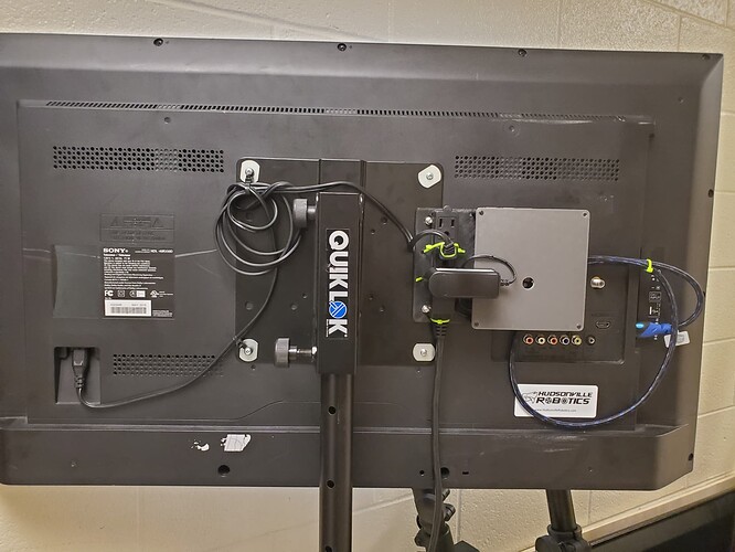

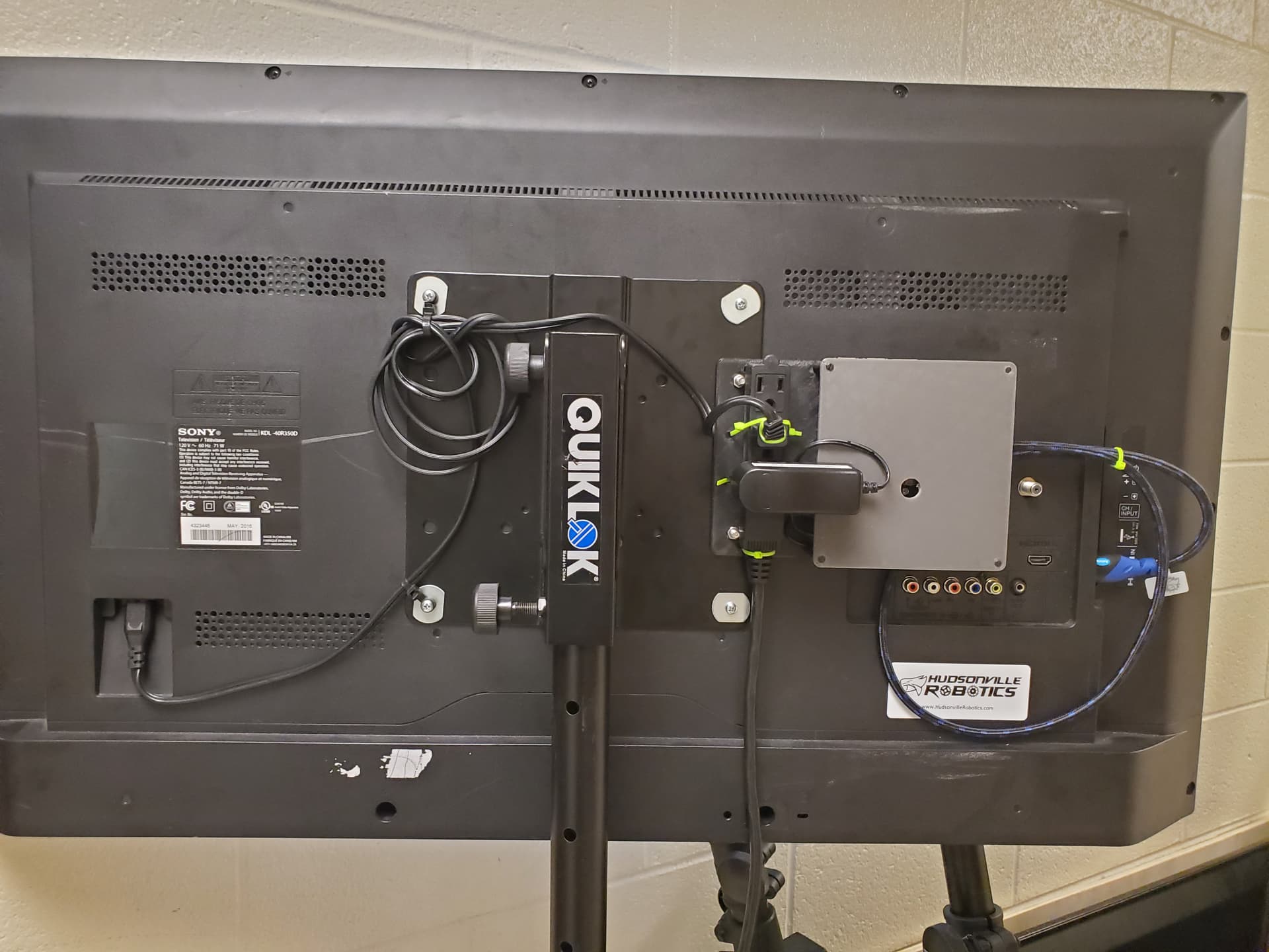

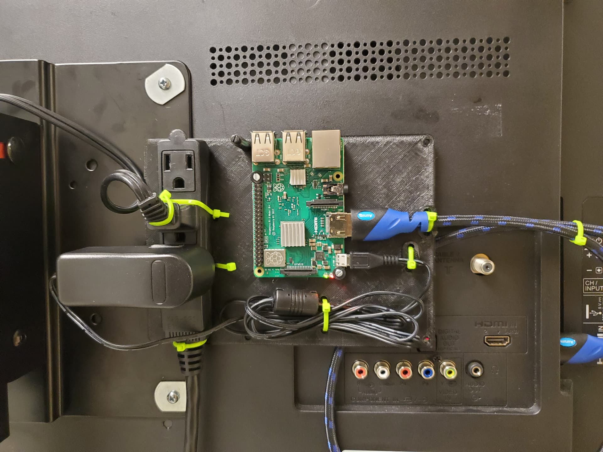

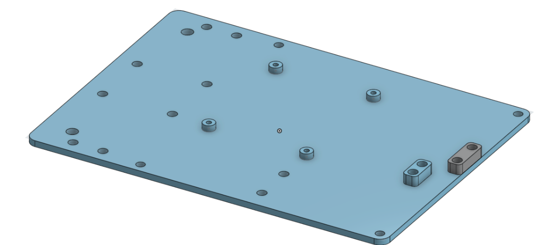

I’m working on brackets to mount Raspberry Pi’s on the back of our tv’s that incorporate an extension cord. So the PI is secured/ protected on the tv. The Pi and the tv plug into the extension cord and are zip tied in place so just one extension cord comes off the tv. I left an outlet open to plug in a field controller or daisy chain another tv. The cover over the Pi snaps on using IQ standoffs. This was the first prototype. We drilled a hole to see the Pi lights. I’ve already changed the design to add a viewing hole for the next one.

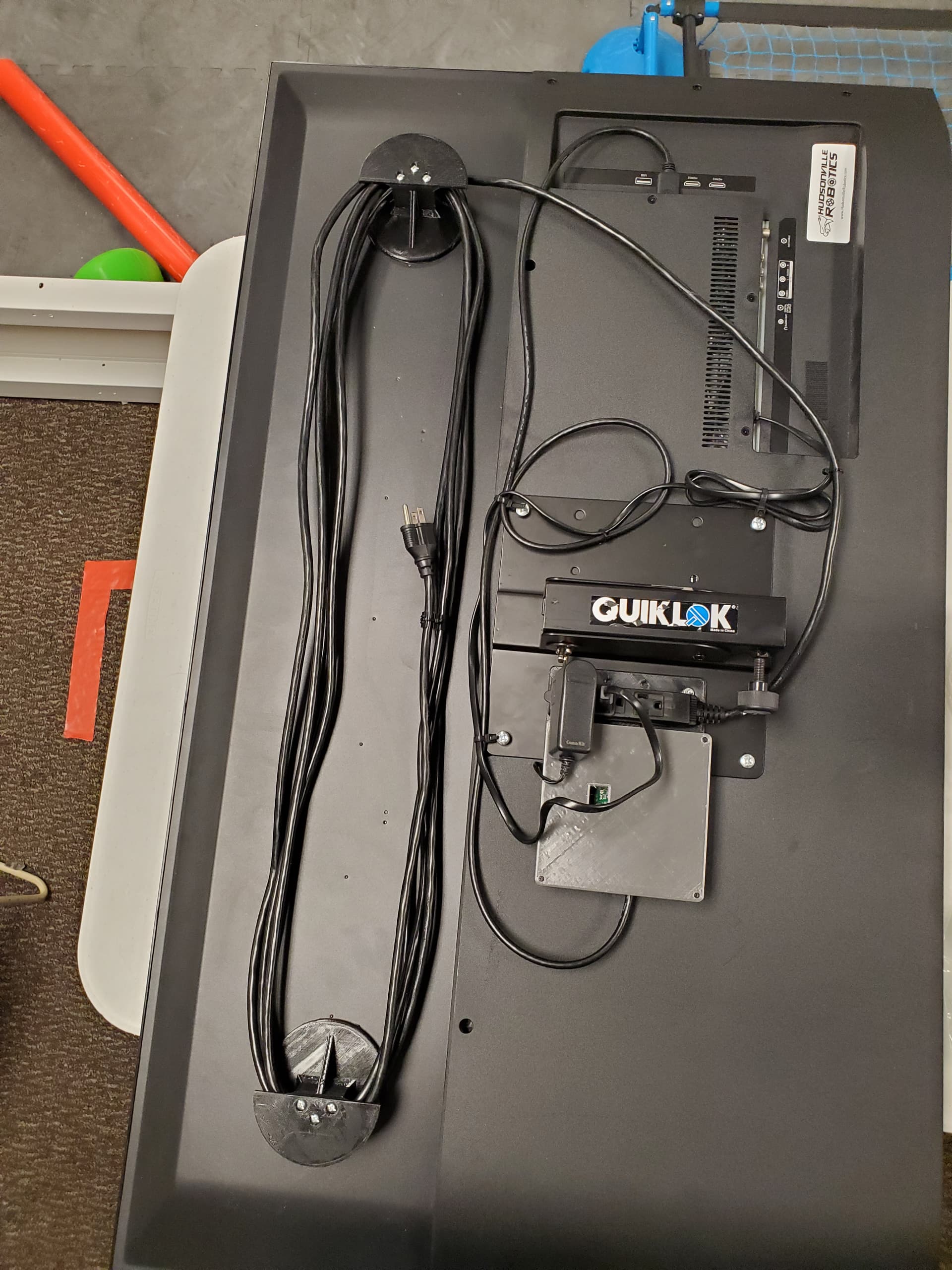

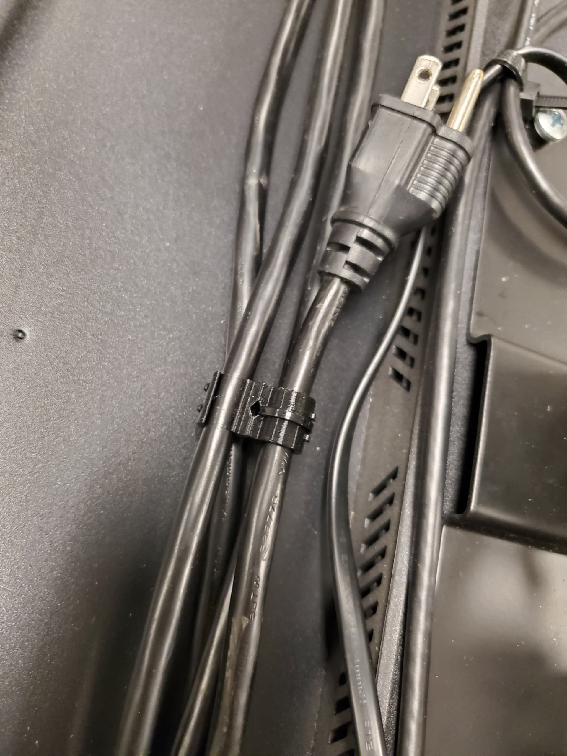

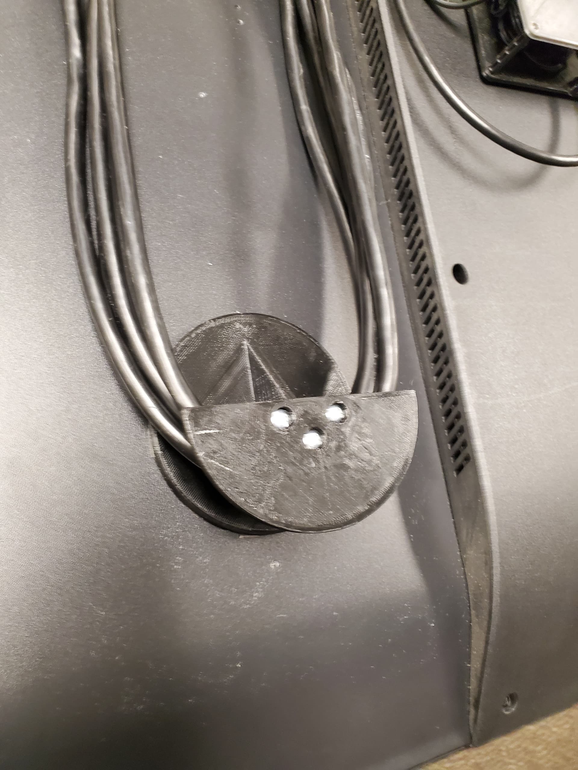

Took the next step and added a cord wrap for the extension cord with a clip that the cord attaches to itself.
