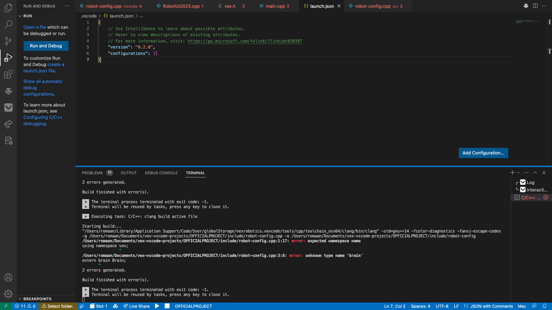

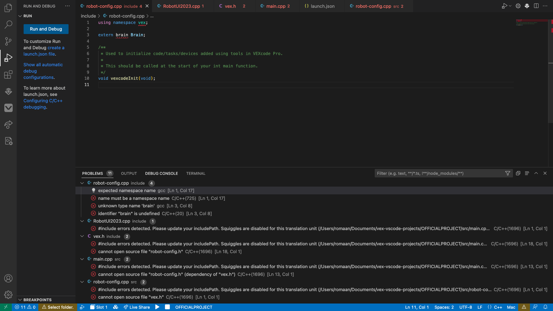

Thanks for that tip, however, when I put in all the code, a lot of errors showed up and I have no idea what they mean. Here are some bugs:
From prior experience, that error usually comes when the folder is opened wrong. Make sure you are opening the immediate parent folder of your project. In your case you would need to use the vscode open folder button and open the folder OFFICIALPROJECT. Judging by the select folder warning in the bottom right corner I’m guessing you opened a file instead of a folder. Here’s a video VSCode How To Open a Folder you don’t need anything past the 30 second mark.

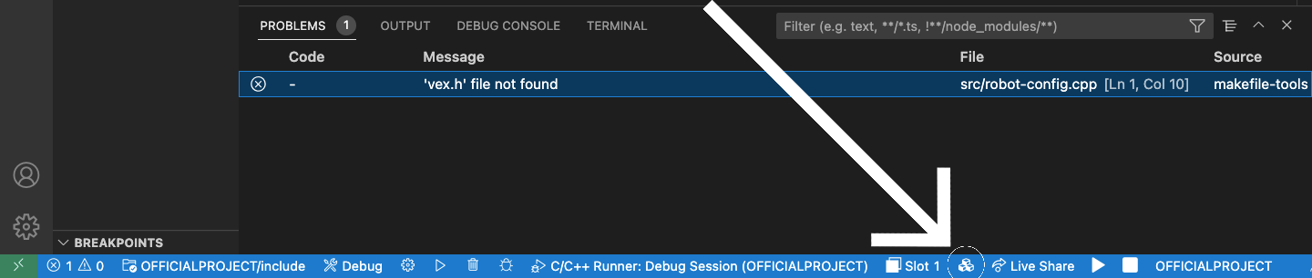

I tried that and I think I got it. Here’s a screen shot of the bottom of my screen

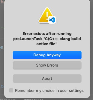

But when I try to debug it, it shows this error

Then, when i select debug anyway, it shows other errors:
‘vex.h’ file not found
and
‘stdio.h’ file not found
Debug is not available for VEX projects.
As jpearman said, debug is not available for vex projects. You can find and fix your errors by looking at the problems tab. You are inside a valid vex project as the extension has activated as evidenced by the vex buttons appearing on the bottom bar. You can click this button to build the button and it will turn into a download button when a vex device is connected

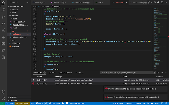

Thank you guys for the help for far. Hopefully, the last problem. After pressing the icon to make it move, it shows this error and doesn’t let us download.
motorOdometry = (((RightMotorBack.rotation(rev) * 6.126) + (LeftMotorBack.rotation(rev) * 6.126)) / 2);
It shows an error and red lines under the words rotation
and it tells you class vex::motor has no member "rotation", which is exactly what the issue is.
That was removed from the motor API over a year ago.
