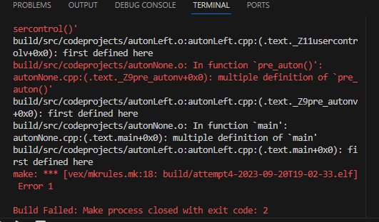

I can’t figure out how to have multiple codes in VSC. I wanted to code for several different autonomous positions and have it all be in one workspace. However, every time I build the code, it gives me several different errors. It looks like all of the errors are that there were “multiple definitions of (xxx)” like “usercontrol()” and “autonomous()”. When I tried the individual files in another workspace by themselves, they worked. Is there a way for me to have all of them in one workspace so that I do not have to break it up?
errorcodes
This is an example of some of the error codes I received.

the OPs issue is that they probably have multiple files in the same project that all have duplicate function names (multiple copies of main etc.)
