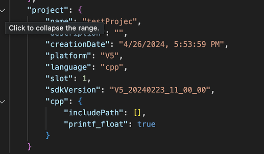

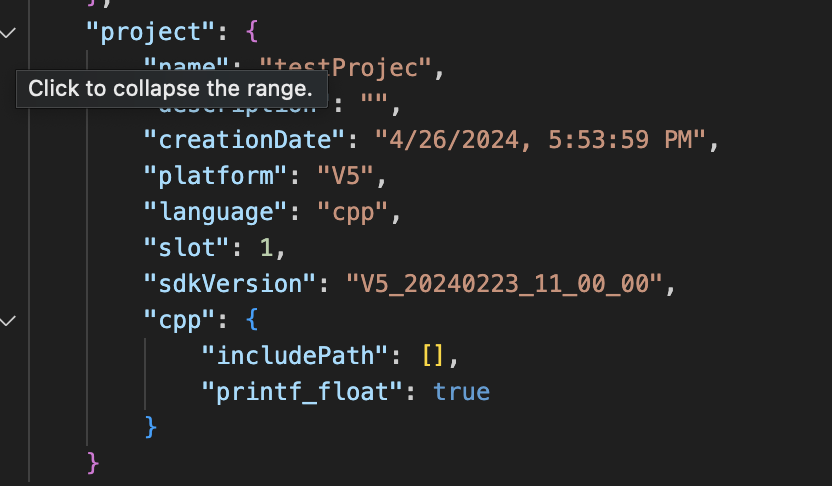

Can you submit a feedback issue so I can take a look at your extension logs?
The sdk version might not be getting updated in the vex_project_setttings.json file when you click save. As a work around for now, you can manually modify project settings file. The file can be found in the ‘.vscode’ folder in your project directory. Finally update the property, “sdkversion”, to “V5_20240223_11_00_00” .
Give that a try and let me know if that resolves your issue. If not, then I can dig into the logs.
I’ve also had this issue over the past few weeks on Win11. I can give this a shot and post back in a bit.
Ah, gotcha, missed the .vscode folder expansion. I changed the vex_project_settings.json as suggested and that worked. I noticed there is also a settings.json file which had the old SDK as well, but that got updated automatically when I changed the first file, so left that one alone.
Let me know if you still want me to submit a feedback.
