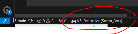

I have a drivetrain c++ project was working, but after a long vacation, vex extension cannot show the build button

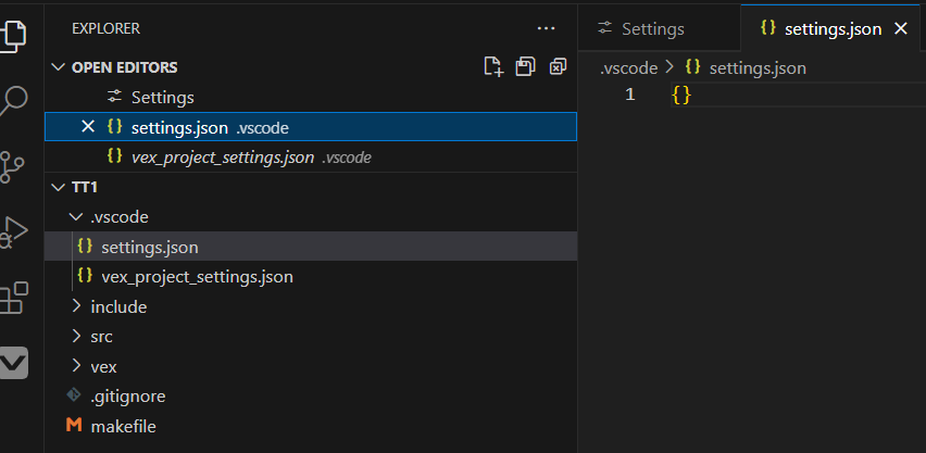

if I create a new v5 c++ project, in .vscode, it mssing c_cpp_properties.json file and settings.json is empty

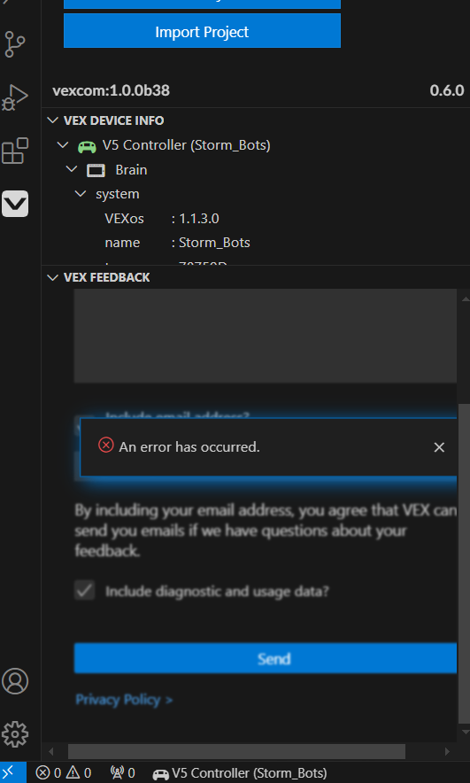

Use feedback after opening the project and Halen can look at the logs. Is vex_project_settings.json still ok ?
I try to send feedback, but fail

As far as submitting feedback, was your computer offline when you tried to submit feedback?

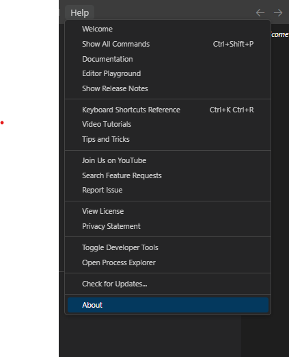

This is the VSCode version:
here is my new created cpp json file

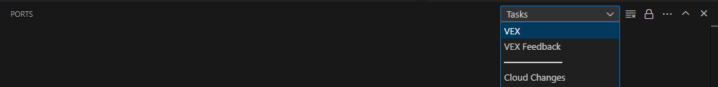

You can find them by doing the following:
  1. Press CTRL + SHIFT + U to open the output tab in the terminal.
  2. Click the dropdown on the top left labled “Tasks” and select VEX from the dropdown.
  3. You should see the VEX Extension log appear.

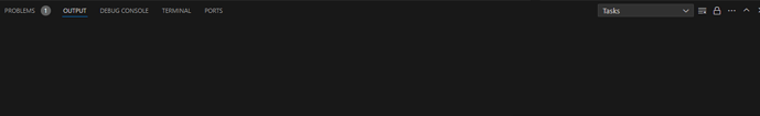

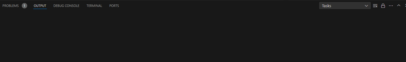

Can you duplicate the issue again and then post your logs here?
new project doesn’t work
Here is my VEX extension log
Thanks for posting your log!
So I had another user report a similar issue but with a python project. I believe the issue is being caused because the VEX Extension is getting initialized/registered before the C/C++ Extension. I think this causes the vscode api to throw an error when the VEX Extension tries to update the settings.json file after your project is first detected.
Since the error gets thrown, you project does not get added to the internal project list and the build toolbar is not shown.
