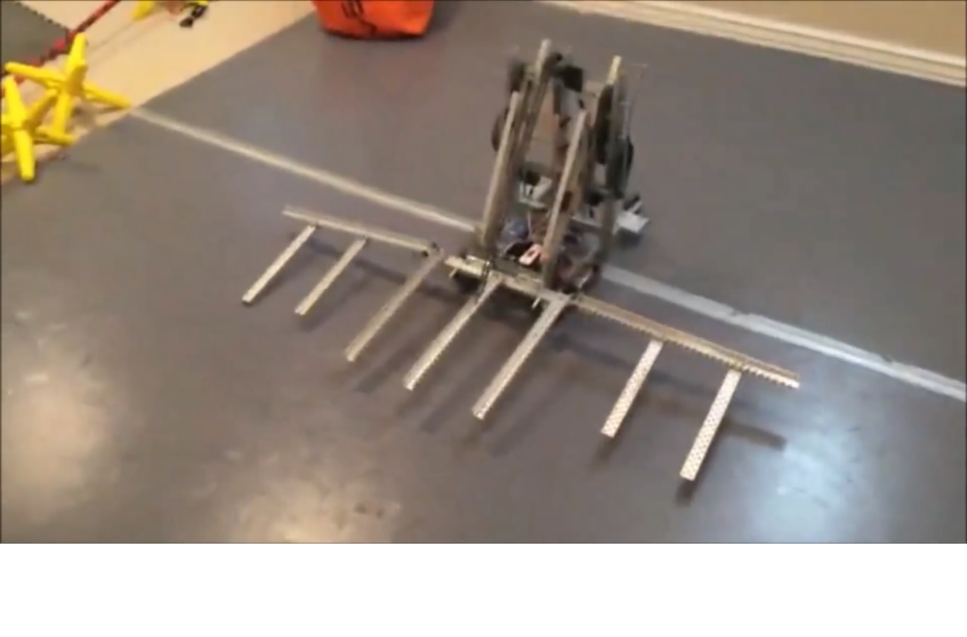

Cant remember where I found this image, but it was saved on my computer…
I have seen 2 wallbots at the 3 tournaments I have been to. One of them did very poorly, as it used a weaved wall of rope which kept getting tangled up. Another one I saw used pullies to lift a steel plate, and ended up loosing in the finals (still pretty good for a defensive bot).
