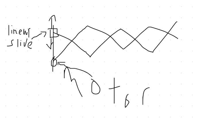

I am planning to make a robot that looks somewhat like this:
05%20PM
How would I calculate the necessary gear ratio to put at each of the motors in order to make the horizontal scissors able to both expand and retract? What gear ratio would you guys recommend using?
having a 1:7 on 100 RPM is probably a safe bet
Make it geared torque first, then speed up the gears to see what you can pull off without working the motors too hard.
if u are building a wall bot i would make a ditaching wall like “wall-e
One of the important things to consider would be the center of gravity of the expanding wall.
In your design, when you expand, everything moves up and, therefore, it will require extra force from the motor. When you retract the wall, COG moves down making it easier on the motor.
You can use strategically placed rubber bands to counteract the force of gravity for the most part or attach the motors to the top bar.
Finally, as an alternative, you can take a look at one of the linkages from TEN FOLD Engineering that were optimized for horizontal expansion:
As for the gear ratio, you have to try it first and then adjust if nesessary.
I might be dumb but is the force of gravity even a factor when expanding horizontally? My thinking is that gravity acts vertically/is what pulls the arm down but doesn’t affect horizontal movement
Not gravity, the center of gravity. There is a difference.

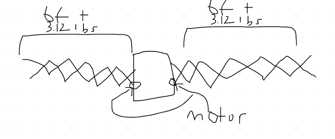

Correct me if I’m wrong, but doesn’t the motor have to slide in order to push the scissors outwards.

The motor doesn’t slide, the other side of the wall slides passively. Here’s a diagram:

Pushing the linear slide up and down involves gravity.
Dont quote me though I’m not super good with scissor lifts

It’s mounted horizontally so gravity is not acting against the wall’s motion(unless I’m missing something). My drawing made it a bit confusing but it’s like a bird’s eye view of the wall if that makes sense.
