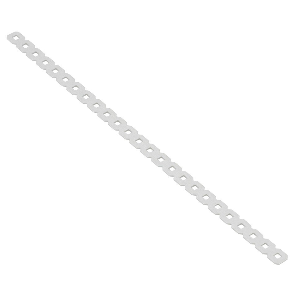

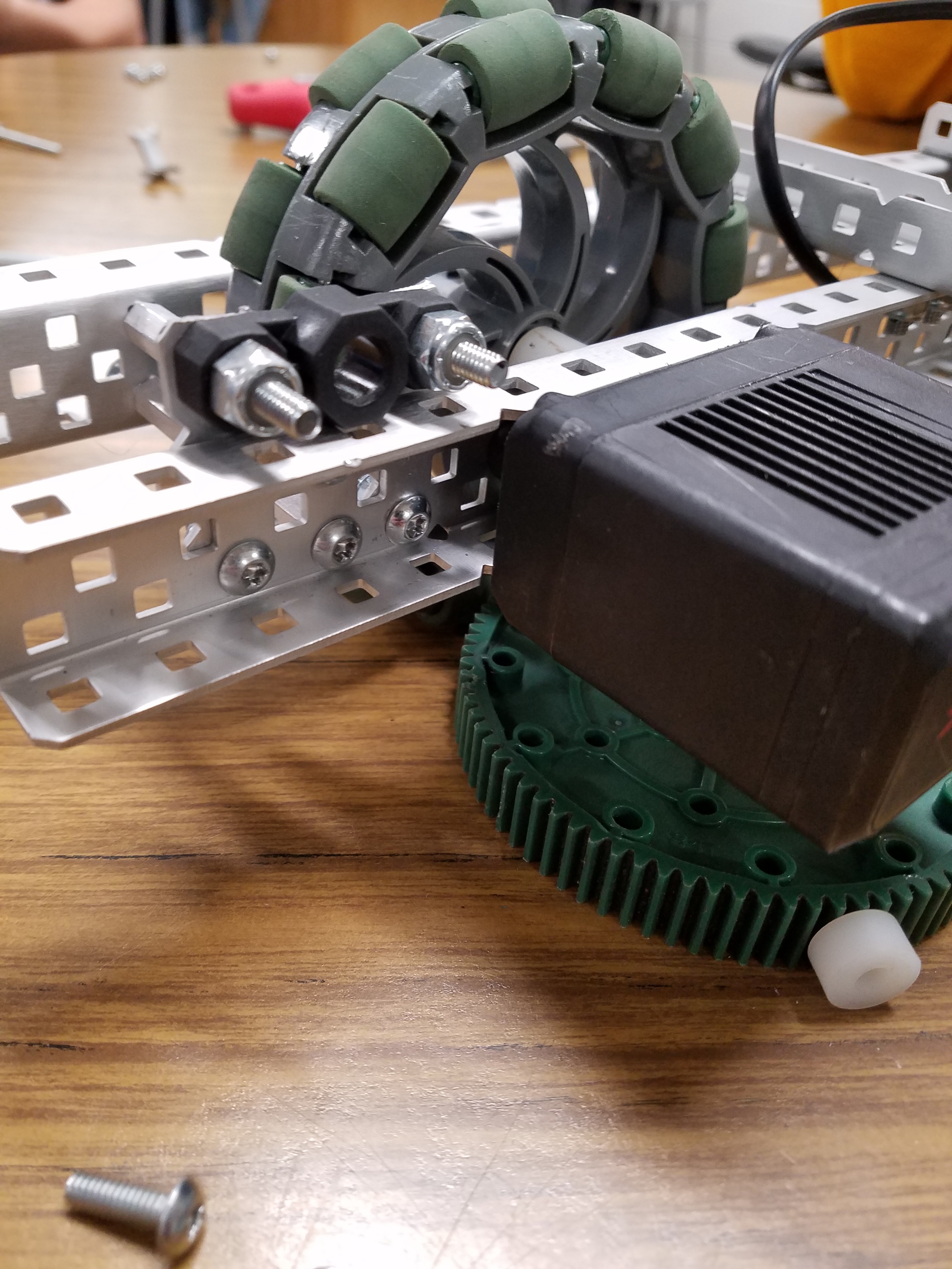

Oh oh right. This is what a team of mine did, and I thought it was rather clever. What they did is they took 2 pieces of 3 long ribbon, attached the first two holes to a piece of C-channel and did the same with another piece of ribbon two holes to the right. What this ends up doing is you have two pieces of ribbon that are sticking up one hole above the C-channel and are one hole apart from each other. Using this you can mount a high-strength bearing flat just above the C channel. YW
Like so
Idea credit to 9457Y
What the frick is ribbon
ā€œribbonā€ isn’t it’s official name, it’s more of a ā€œstreet nameā€ that everyone uses for it.
Never heard that in my two years XD thx
never heard that name for it either in my 5 years of vex
I’ve heard multiple teams/programs use it in my 5 years of vex. Must be a Mankato thing? lol
What do you call it out of curiosity?
I call them 1x1 metal strips
i call them the long skinny bois
everything on my team is called (insert name) boi(s)
yeah we have c-channel, thiccck boi c-channel, and thiqk boi c-channel
we call ā€œribbonsā€ @Avonderweidt-channel

no, don’t do that the HS will be under tremendous stress and eventually the plastic will just grind away breaking your mechanism.
