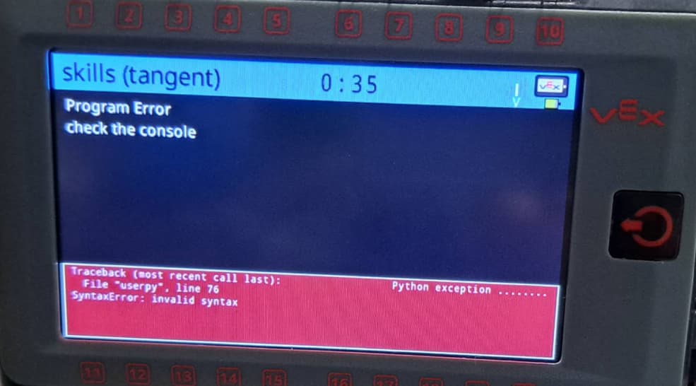

However, when we use the VEX example block code to run it, it always tell error as following (although we don’t use python, but it says something about python):

Unless I can’t see it, you are missing parenthesis on your travel distance… or you could just use the square command (x^2). Not sure if this is your problem, but you’re probably getting some really bad calculations from this.

I can’t see all of your code, but perhaps try the VEXcode update they released tonight and see if that fixes the issue.
Thanks. We use block to program it, not python or C language.
Thanks. The code in blocks is VEX official example. The weird thing is that we never used python or c language, but when we run the blocks, the error always come out like the above screenshot.
That’s because the blocks need to be converted to text to be able to be run on the V5 brain. It used to be C++, but recently the VEXcode team decided to switch to Python, hence all the Python errors as Python detects these at runtime whereas C++ would have caught them during the compile stage prior to downloading to the brain.
I went back and looked at the math in the x2+y2 section. That looks right. I just couldn’t see it close enough when I looked.
I’d still go back and add the ‘display’ and ‘pause’ commands, then check the brain’s output.
Also, the ‘printposition’ subroutines are not shown… maybe code problem is in there.
Could reset brain and push code in again. This has solved problems several times in the past.
Finally… just do it again from scratch and save into a a different slot. I’ve seen block code get corrupted on more than one instance.
