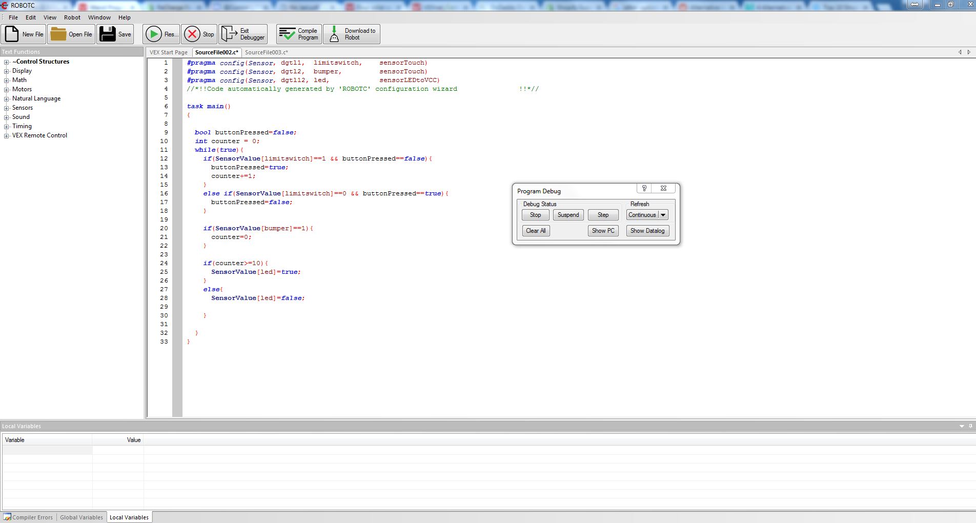

Try downloading to robot and going to Robot>Debugger Windows>Global Variables and click “start” on debugging and see what happens when you hold down the limit switch. Does it just increase infinitely?
It doesn’t show anything. It just turns on after 1 click.
Same Thing, shows nothing and turns on after 1 click.

To get the variables to show I have to click the “step” button and then it shows the variables but then they don’t update until I click stop, start, click limit switch, then click “step”.
Here is after 1 click, it seems to be inconsistent…
I am sorry, I don’t think I quite understand where to put it,
