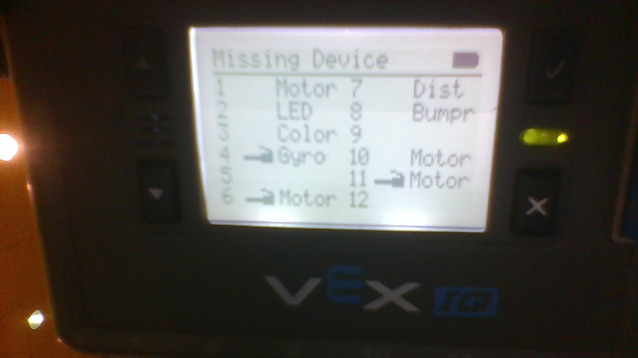

It says this, but my build does not even have these on here does anyone has a fix?
By the way, It Says
Missing Device
COLOR BUMPR
LED DIST
MOTOR MOTOR
IMG_20191011_103949
Do you have a program loaded that wants those devices? It checks to see if you have things loaded.
Are you running one of the built-in programs? Is so, which one?

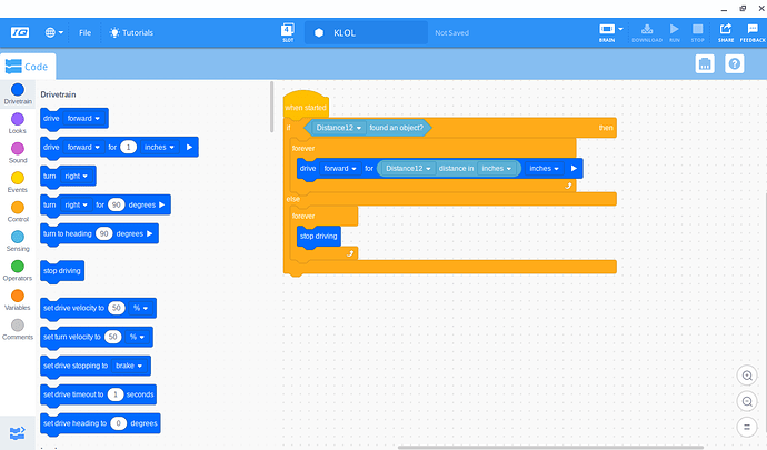

If not, are you running a custom program (e.g. something you wrote in VEXcode, ROBOTC, Modkit, etc)?
Are you running the latest version of VEXos (2.1.3)?
I’m running a custom one and yes I’m running the newest version of VEXos
Noo Its The Customcone, Here (Btw I know It’s not done but after I downloaded it any program I tried to run it said “blah blah blah things not plugged in”)

What devices are configured if you click on the port icon?
I can’t click on it. Maybe my brain is just glitched :thinking:
