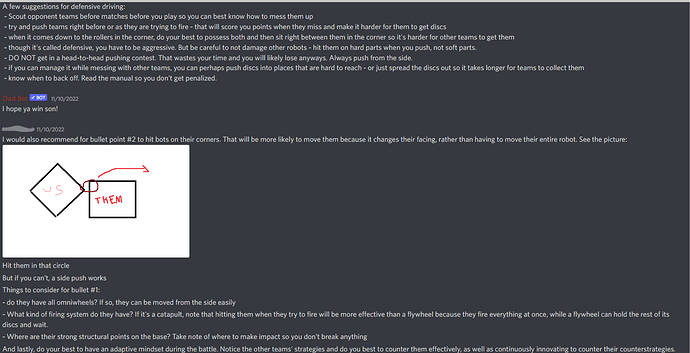

Our team also does not have a fully completed robot(our intake wasn’t finished in time, but we have a flywheel, a roller mech, and maybe string launchers), so I was dreaming up strategies on our team’s discord:
(Ignore the dad bot lol)

For VRC push bots it is best to have a fast but high torque drive train, and have a good driver there are some good match videos showing defensive strategies (definitely not biased because we were the ones doing the defense in 2/3 of these videos lol)
Our bot does have omni wheels. It’s to help us turn.
In my experience, the best strategy for a push bot is to get in the way of other robots. Whether that be in between them and a roller, them and discs, them and a goal, etc.
This year, however, pushbots don’t have much of a place. If you’re able to make even the simplest of roller mechanisms, do it. It’ll give you a purpose outside of screwing up other robots, which means you’ll be of more value to alliance partners, and it’ll give you at least a little viability in skills.

push other teams when they’re trying to make shots or shove discs into low goal
If you can, get a roller wheel on there. Turning all 4 rollers from the opposing color to yours is an 80 point swing, and could really help towards winning a lot of close matches.
It gives you 40 points while denying the opponent another 40, so it could be said that it’s an 80 point swing.
