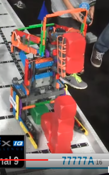

I think 10622D means something more like this
A multiblock “claw” that can stack.
|221px;x354px;

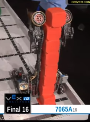

Whereas I think MyrddinEmyrs is favoring something like this:
|295px;x399px;
World Finals VEX IQ Highrise - 2587x Discobots (264pts) - YouTube
