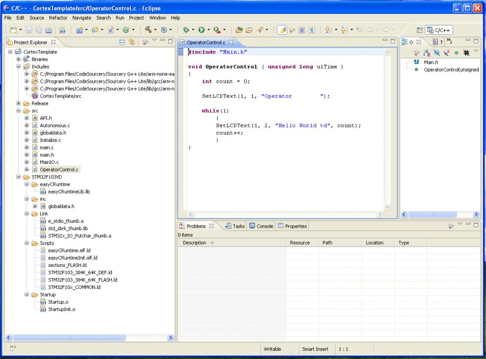

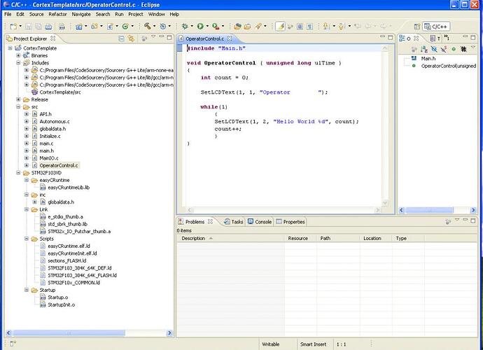

Did I say windows only? No, you could do eclipse/EasyC under linux or OSX as well.
EasyC uses GCC, I think PROS will have a better runtime library than EasyC but otherwise it would be a very similar development experience. Don’t misunderstand, I’m excited to see alternative tools being developed as well.
This is what the eclipse/EasyC hybrid looks like.
[ATTACH]7393[/ATTACH]
