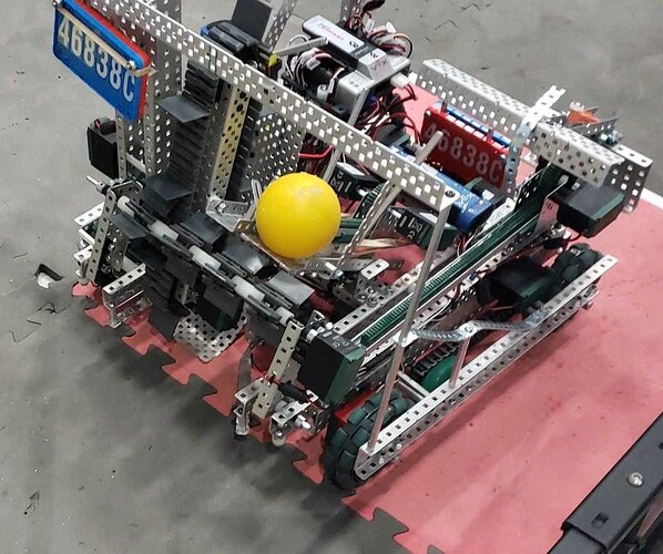

I can’t very clearly see your robot in the video. But from what I can see, it looks like it would be relatively easy to add a centered ball loader with a puncher/plunger. From what it looks like you definitely have the open space to do so. From what I’ve seen in competitions, high scoring caps doesn’t seem to be all that time effective for the points and how easy it is for caps to get knocked off. So, I would probably not recommend building an arm if you are restrained for time.

As others have said, the puncher is pretty easy to make and doesn’t take much time. We use the conveyor pieces as a flipper to intake balls (and flip caps if running reverse), and have a larger conveyor that lifts the balls vertically into the puncher. This took us roughly 2 meetings to put together and make work on the robot. The girls built it pretty modularly and just bolted it to our chassis (picture attached - note the intake flipper is in the retracted/lifted position to fit the 18 inches - it flips down at the start of the match).
Its hard to make out, but your bot looks like a basic square chassis and may be open in the middle. If so, modifying this for a ball intake and mounting of the puncher wouldn’t be hard. If done similar to ours, it would take 3 additional motors, however you could get away with 2 if you made your ball conveyor and flipper run off one motor. intake
