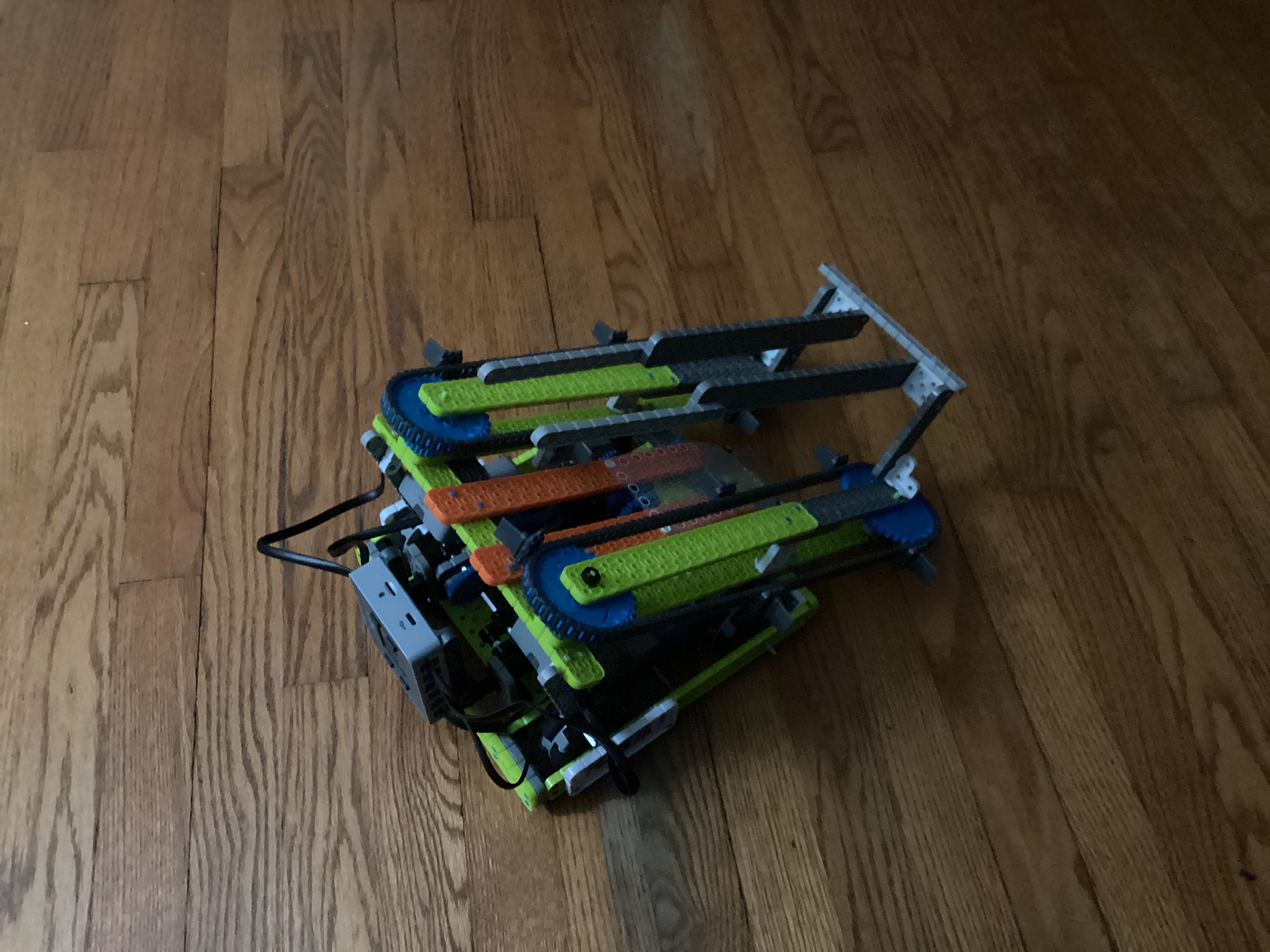

P.S. this is our robot (it not complete)
@76782AHighVoltage Nice robot! I even have an idea of how you could use this to score on the standoff goal. If… and IF… you have pnuematics, you could adjust the robot so that you can change the angle of the conveyor platform to reach high places. Great design! This is much different from what everyone else is doing!

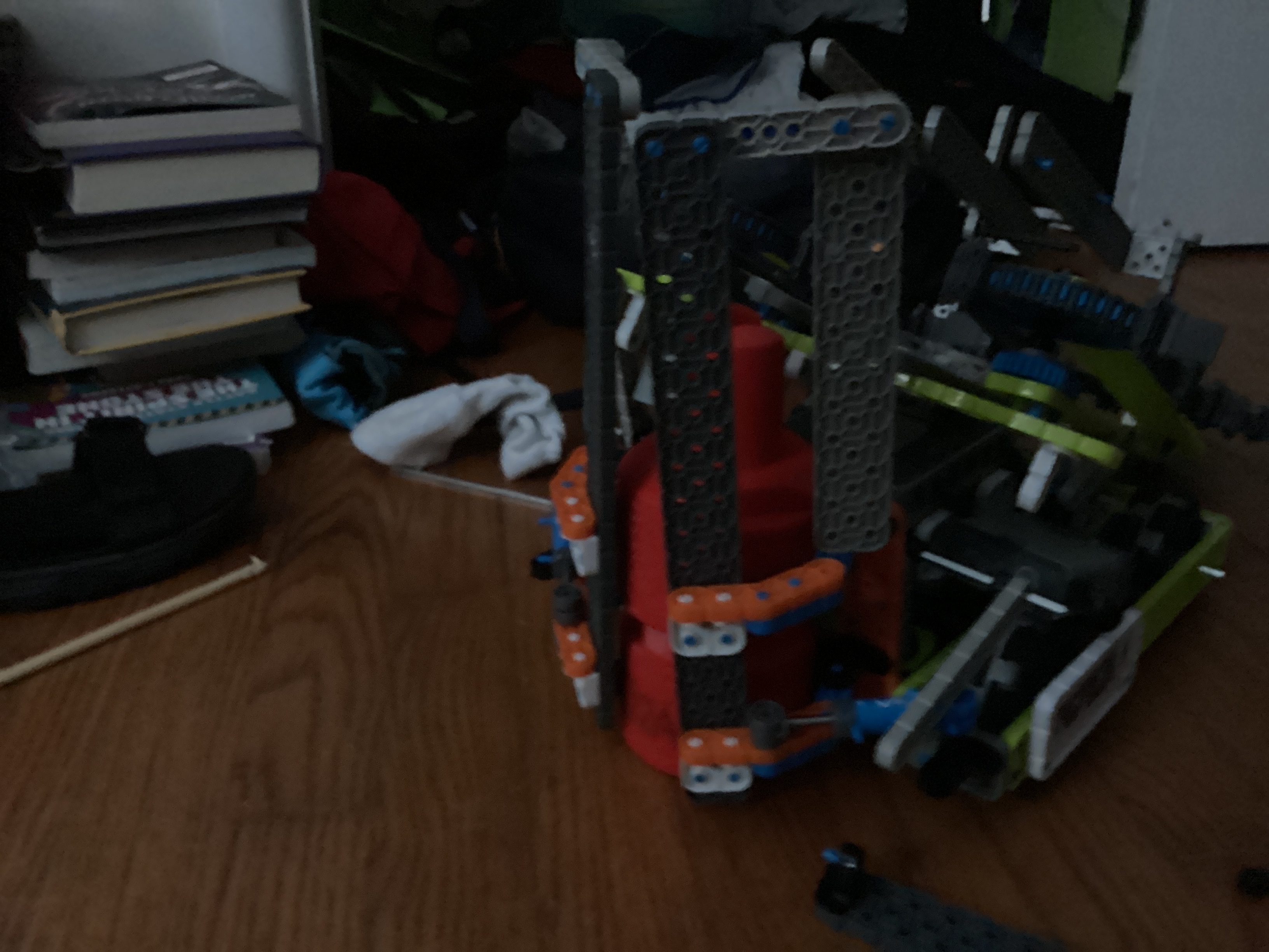

Actually, I was just working on the stand-off goal. We are going to lift this back claw;

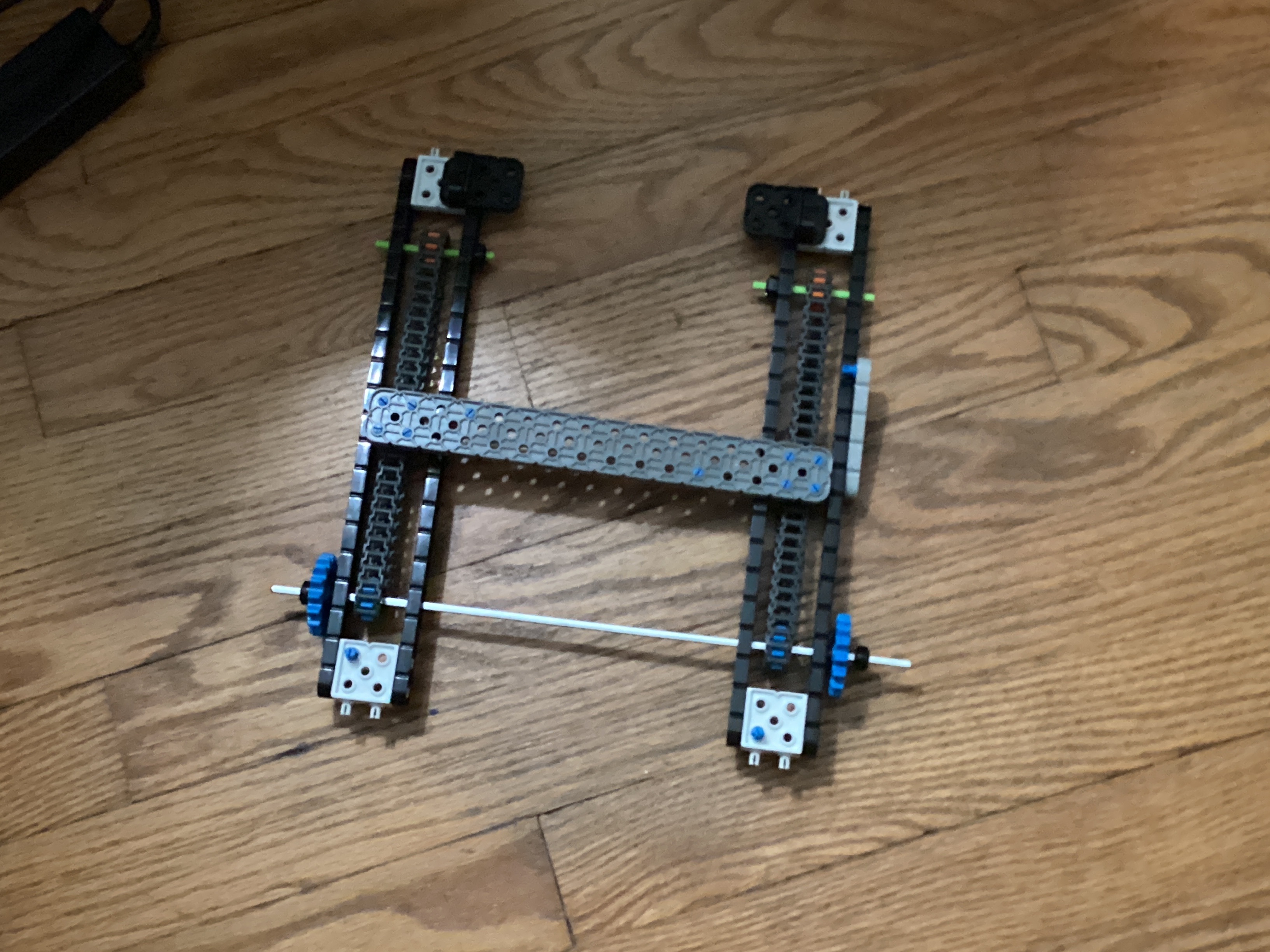

Using some lift mech like this
We are planning to have the game objects taken up with the claw allowing us to put a stack in the triangle goals and the stand-off goal.
@76782AHighVoltage I was also thinking some thing about this my brother was thinking to make a claw on the back of the belt or (Escalator). Thank You for everyone Time and Cooperation and Ideas
@76782AHighVoltage My brother said that in the background😂. He is making robot Similar to your robot but without using Pneumatics and without X Drive, but a (two motor drivetrain).
