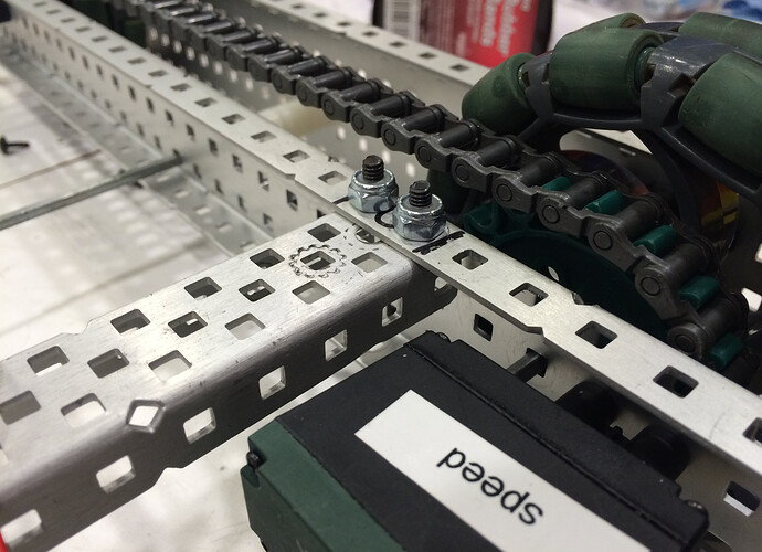

With C channel, use whatever orientation will provide the strongest attachment. Flat surfaces together are much stronger than the other way around. If you do need to have a gap, fill it with spacers or washers to prevent the clamping force of the bolt from crushing the C channel. (See second attachment for an example of a flat to flat attachment)

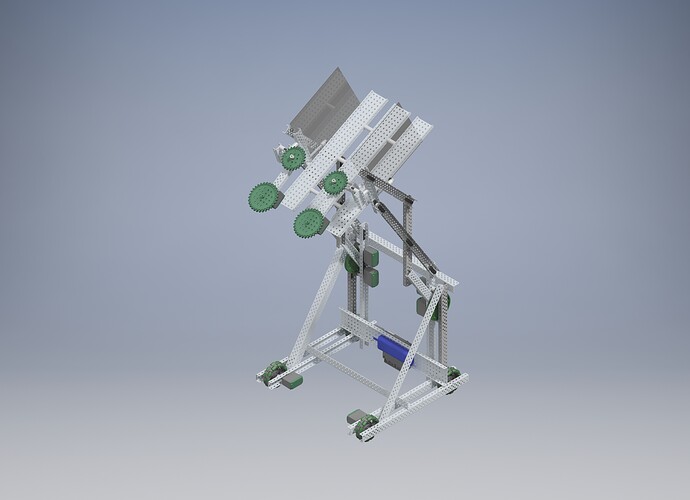

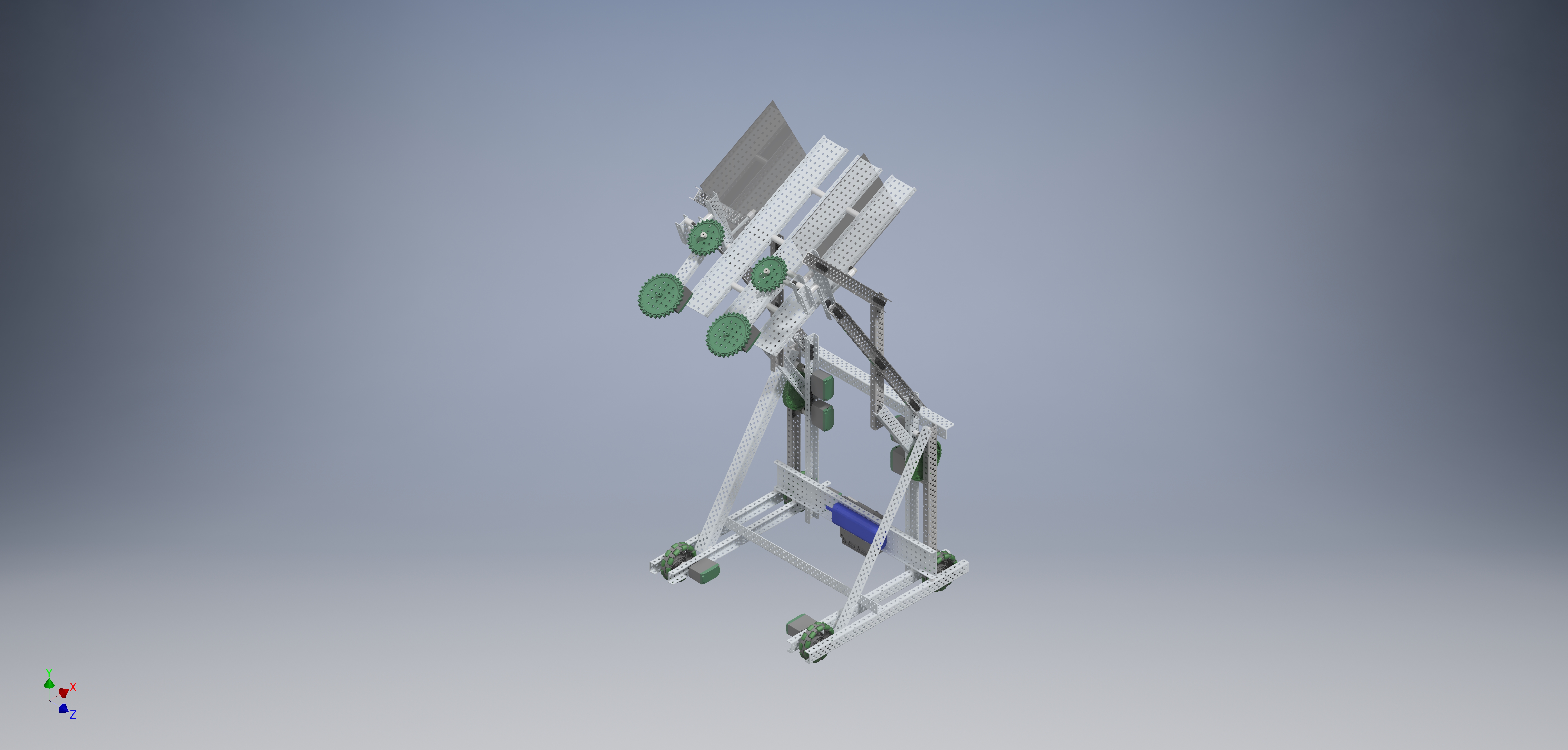

The most common drivetrain is four speed internal motors in direct drive to four 4in omni wheels with two wheels the left and right. This gives you a good platform to build you scoring device on. This type of drivetrain is very simple to build and you can build it very quickly.
The Open Source Starstruck Robot pretty much uses the standard everything.

A 5-wide c-channel and triangle supports from whatever you have left works well (see OSSR)
