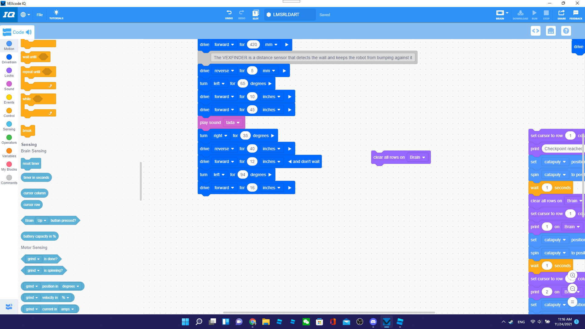

This is really just making me angered today. The “and don’t wait” block attachment is there, but when the code is ran, the attachment just skips the code with the “and don’t wait” attachment. Is there a way to fix this?
Code:
The turn left “overtakes” the forward above it. I’m assuming you what it to drive forward, and then turn left.

Command 2 “overtakes” command one because they are both using the same motor. This is the mistake you are making above. You will typically only use “and don’t wait” wieh you are controlling different things.
Code runs from top to bottom, “And Don’t Wait” makes it to where that line of code runs at the same time as the previous one does.
