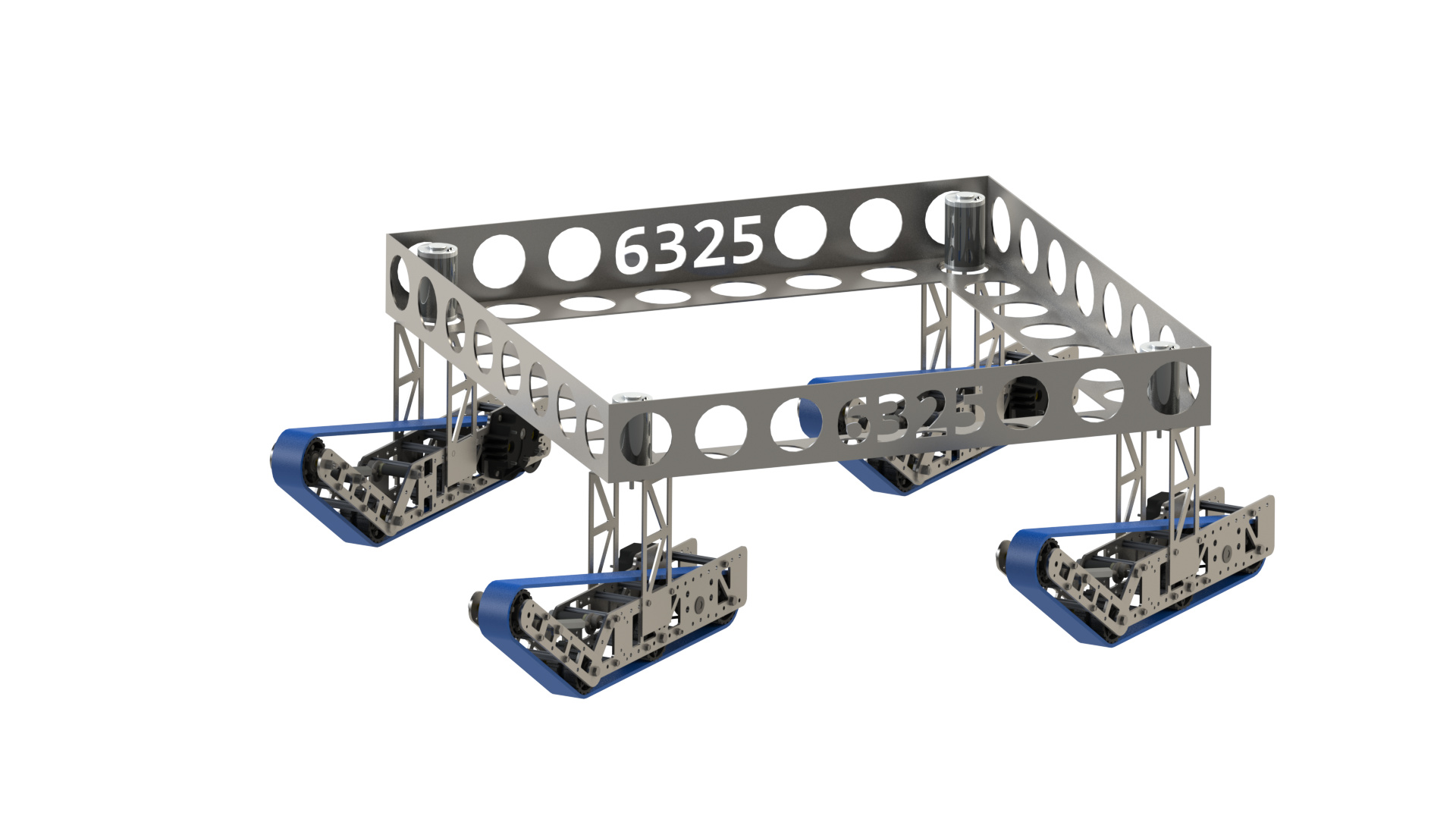

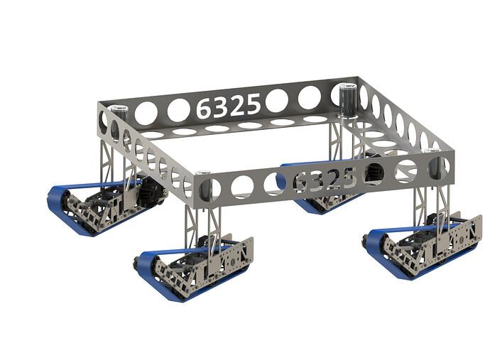

I think the only way to solve the dilemma between which configuration and wheels are better is to introduce the all-powerful, best type of drive. I present to you, the
** * ## T A N K T R E A D S W E R V E D R I V E * **
Don’t copy my robot like that
Hey VexU meta right there
