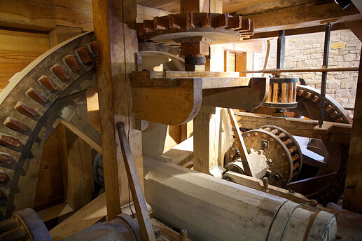

This image is from George Washington’s gristmill, and shows some nice examples of cogs. While some people might use the term “cog” and “gear” interchangably, usually a cog is a specialized type of gear, normally wooden, consisting of pegs or teeth driven into a disk. Cogs can engage with each other, or, as shown in the photo, with a wooden gear (near the top center) or with a “lantern pinion” or “cage gear” as in the cogs on the right.
