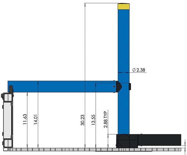

The hight of the tall pvc pipe is about 3 feet but with the cap its about 2ft and 10 in
where did you find this image? is it in the game manual, and if so what page is it. thank you!
Field specifications are found in appendix a of the game manual
It’s in appendix A which is closer to the back. On my pdf it starts on page 79. If you are using the vrc hub, it doesn’t have the appendixes so you need to download the real thing.
