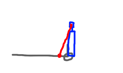

Would it be possible with single acting cylinders?
yes, it’s definitely possible. most people use the double acting cylinders as single acting anyways, just with an external rubber band to close it instead of an internal spring.
Just make sure the thing is active clamp and spring release, because you need a lot more force to clamp than you do to release.
But how would that work with a mogo lift made out of single acting cylinders? Would at have to be on a pivot facing the other direction in order to lift it up?
well the exact geometry depends on what you’re using the cylinders for.
are you trying to make a clamp that holds a goal at the end of a lift, or are you trying to make some sort of forklift to hold and pick up goals into your robot?

We’re trying to make a forklift that picks up mogos

yeah then you’re going to have to get a little creative with your cylinder placement.
consider this crude sketch:
Single acting forklift motion
when the cylinder (blue) extends, you could have either a cable, or perhaps a linkage (red) pull up on the forklift (grey), lifting it up on a joint.

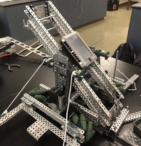

I never stress tested the one lift I had, the lift was just a four bar but it could lift from the from or back, making the mogos weight counteract the mogos on the other side. It was built for two and probably could have held more. It used only one motor and was great, but it was just not right for what we wanted. :,( you will be missed
Do you have any videos of this robot in action you would be willing to share?
