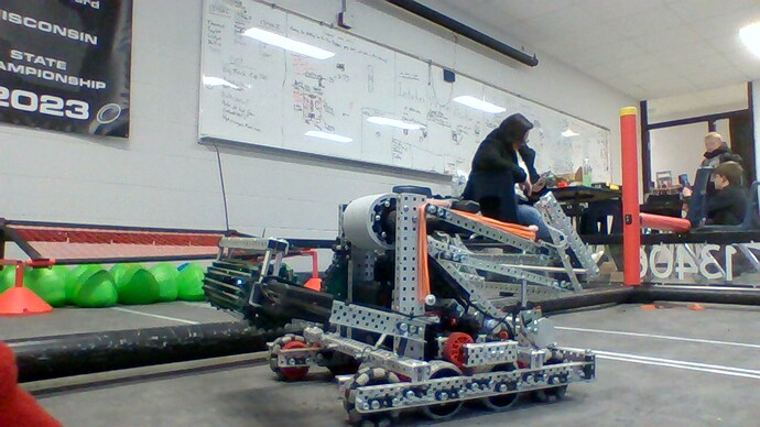

I would recommend horizontal flex wheels. We started with rubber band and it worked really well, except for getting entangled. A solution for this is a mesh roller. lots of teams have thrived using this, but you have to replace the rubber bands under the mesh every so often and it’s hard to tell when to do so. We settled on small flex wheels, as they are pretty easy to set up, don’t get entangled and are consistent. here is a picture of our intake rn
we are planning to add intake sleds to help us score in goal more consistently but I’m really loving this intake. my only suggestion is making sure you aren’t hinging intake too far forward. this can lead to difficulties intaking as well as possessing, as well as trouble scoring in goal from intake.

I noticed in your picture that there is no place for the triball to rest after you intake it. I’ve seen teams utilize rubber bands, string, or even c-channels for this.
I completely agree, this could get you called out at a competition.

Yeah this was from earlier this week, we just zip tied some rubber bands across the intake chamber to hold triballs

nah we wanna be like gremlin but we’re too lazy. I just put it in a vice and bent it. gremlins is better, and if you have the time/resources I would do that. also ours is unnecessarily big so if your making a similar design, make it smaller like gremlins. we just had plenty of plastic and were rushing to be ready for a tourney so I didn’t cad it.

We are going to be sizing down the 4 bar bc it is just mostly for hang.
Use rubberbands and DONT defense with the intake.
The 24 tooth gears are for inertia and are going to be moved to the inside of the flex wheels.
