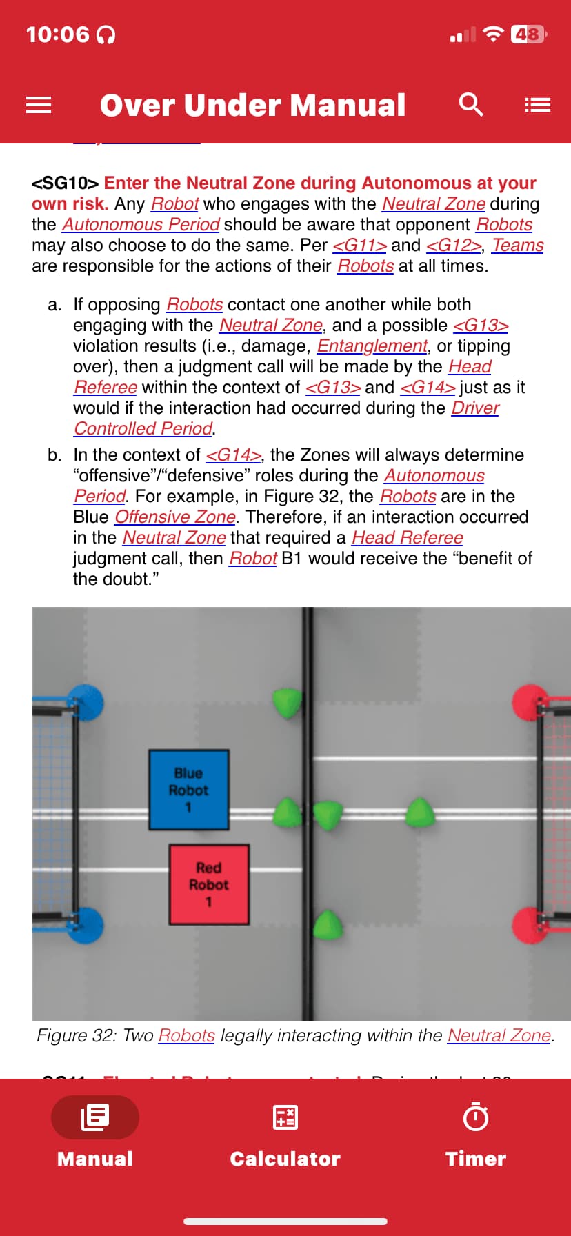

From what I understand, it seems to only be effective during autonomous. SG10 has one of the only mentions of it, so I assume that it’s only used during autonomous and not for determining triball scoring.
So what is the zone’s purpose? Are you not allowed to cross it during the autonomous period?

You can cross it, as long as you don’t cross the farthest line (double or single) from where you started. For example, in the picture I included of SG10, as long as the red robot doesn’t cross the double line in the middle and the blue robot doesn’t cross the single line representing the neutral zone, it’s fine.

It looks like it favours the offensive team in that half of the field, giving them more access to the goal. The defensive robot has less access to block the goal. What is the relevance of the double line? This is not really referenced in the rules as SG9 just states During the Autonomous Period, Robots
may not contact foam tiles, Triballs, or Field Elements on the opposing Alliance’s side of the Neutral
Zone

The neutral zones are placed such that they benefit the robot starting on their own offensive side at the beginning of the match. This will allow the robots starting on their offensive side easier access to the two triballs. Since the tribals sit on the double line and they are rather large and awkward, it is likely that an intake mechanism for picking up the tribes will cause them to shift forward a bit when picking them up. The neutral zone gives a bit more room to achieve this during autonomous. It doesn’t prevent the robot starting on the defensive side from going after the Reuleaux tetrahedrons, but it makes it more difficult for them to pick them up since they are on the far boundary of the autonomous zone, so go after those Reutets at your own risk. SG10b also spells out that the robot on the offensive side will get the “benefit of the doubt” in any interaction around the neutral zones.
Conversely, the robot on the defensive side of the field at the start will have access to one of their alliance match load zones, where a preset acorn will be sitting. That oak nut must be removed in order to gain the AWP.
The GDC seems to be discouraging head-to-head interaction between opposing robots during autonomous while not outlawing it entirely.
