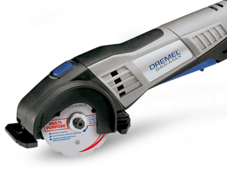

This kinda isnt related, but I have a dremel, but don’t have the cutting disk. What are you guys using?
The e-z-lock cutting disks are nice, but be sure you make some practice cuts with ordinary cheap disks (you’ll break a bunch until you get a steady hand). We prefer other methods as the first-line of cutting. Dremel is a last-resort.
depends on what dremel you have, as kmmohn said the ez lock cutting disks are nice, but they do seem to break easy. image i use a dremel like this and it seems to be the best for cutting

I have this one. Which disks would work. I think I need a circle in the middle of the disk.
That kit uses ordinary cut-off wheels (with a little hole in the middle). You can usually get a 25 pack at a home center or hardware store. If you want to use the Dremel EZ Lock, you have to start with a “starter kit” which includes the mandrel to hold the wheels.
