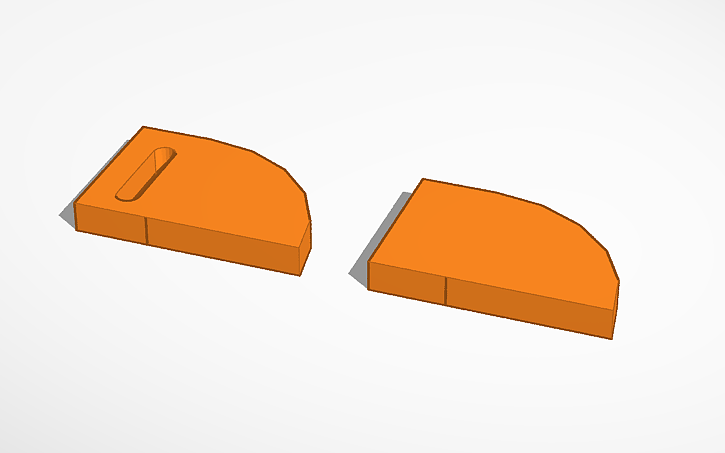

Anyways, use barrier sleds to help you get over the barrier
What I’ve seen is that any size wheel can get over the barrier with a built in ramp. The deciding factor is your offset gears. If they are too large, they will get your robot stuck in the barrier. What you described sounds good.
Also even if you decide to off set your gears, many teams add like a bar that is lower than your gear, in order to smoothly go over the bar.
