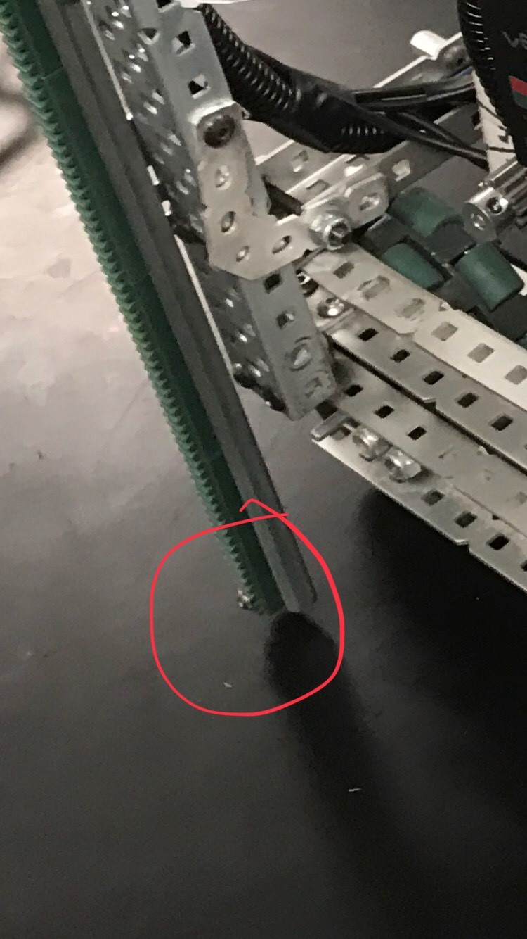

EDIT: If your mobile goal lift is of the rack-and-pinion kind, this is something I did for Starstruck to prevent my high hang lift from going too high and exiting the robot. I took a rack gear and a 6-32 screw (the kind the motors use), and put the screw in one of the “nuts” from the opposite side. To do this, I drilled through the rack above the nut to gain access to the other side. Here’s a picture of what I mean:
rack and pinion stop.jpgW
When this hits the pinion gear, the rack will stop moving, and this won’t damage anything, even the pinion gear itself. If one of the nuts is at the right height for the mobile goal, you can use this trick.
