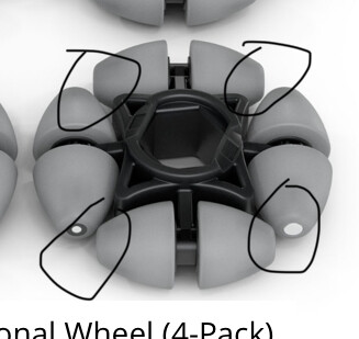

I want to do odom for my autonomous program but I don’t know whether I should use 2" or 2.75" wheels. The smaller the wheels the more accurate the tracking is but I was playing around with the 2" wheels and they seem to kinda get stuck from moving side to side in the corners. I was wondering if this is a problem or not. Thanks.

in this photo I have circled the points that the wheel gets stuck in moving sideways.
Can you describe what the wheels are getting stuck on?
Since the rollers are so big for a small wheel the area @spaghettoid circled is where the rollers barely make contact with the floor. So basically the wheel is just dragged.
And it getting stuck really isn’t a problem because it isn’t likely you will be pushed exactly sideways and even if you were, the wheels still work, they just have a bit of friction in that exact position.
I see.
In that case maybe just transition to 2.75inch omni wheels. The dragging problem doesn’t really seem very fixable in a good way.

honestly I don’t really think it would be a really big problem but if the friction gets crazy high then you could cut the edges of each roller abit

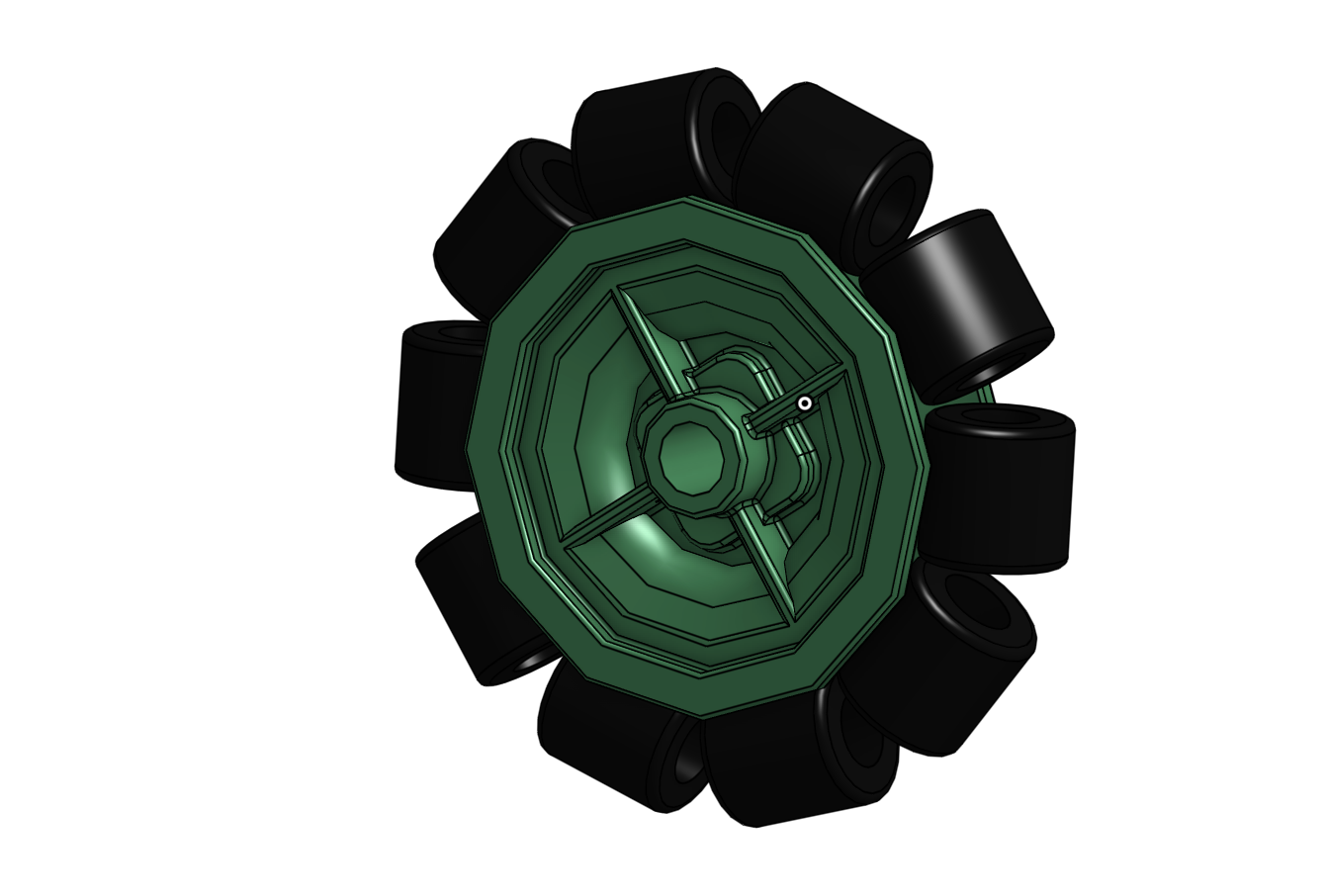

Another option is to use VEX parts to make your own omni wheels. Ill try and find an image now.
Found it.
Ive seen these held together with zip ties, but I don’t know how well they work.

Idk if it has been mentioned already, but the 2 in wheels having the small gap because the rollers are too big causes another problem in that when its pushed to the side it will actually slightly offset the wheel, which can mess up the Odom’s tracking.
