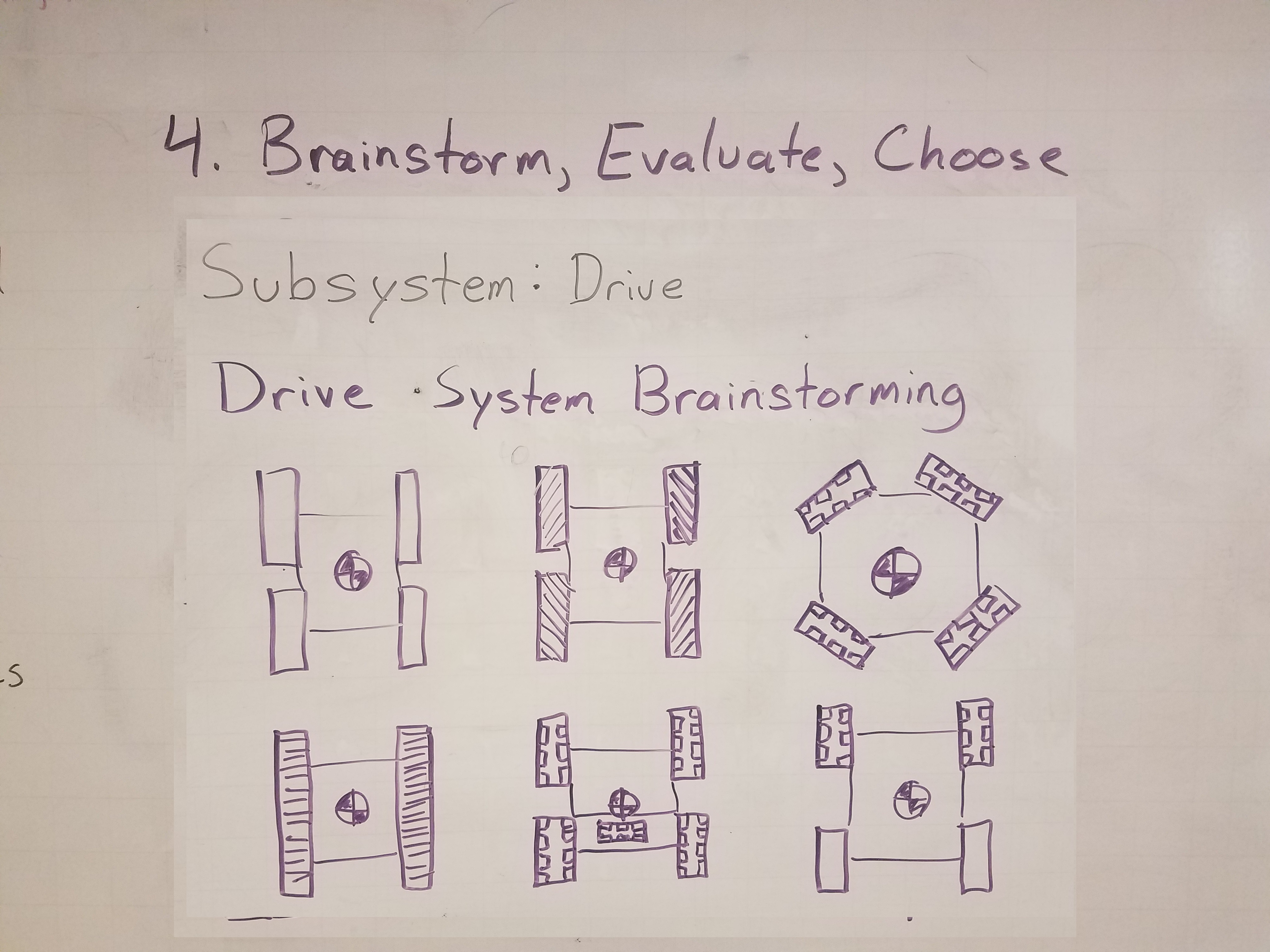

@RoboCats There is no magical universal “best” anything. Everything has its own pros and cons.
However, you can use the engineering design process to determine for yourself, what may be the best option for your specific team and strategy.
  1. Define the problem.
  2. Background Research.
  3. Specify Requirements.
  4. Brainstorm, Evaluate, Choose.
  5. Develop and Protoype.
  6. Test Solution.
  7. Communicate Results.
Also remember, it is an iterative design cycle, not a one and done formula. Be prepared to revisit previous steps, sometimes over and over, until you meet your goal.

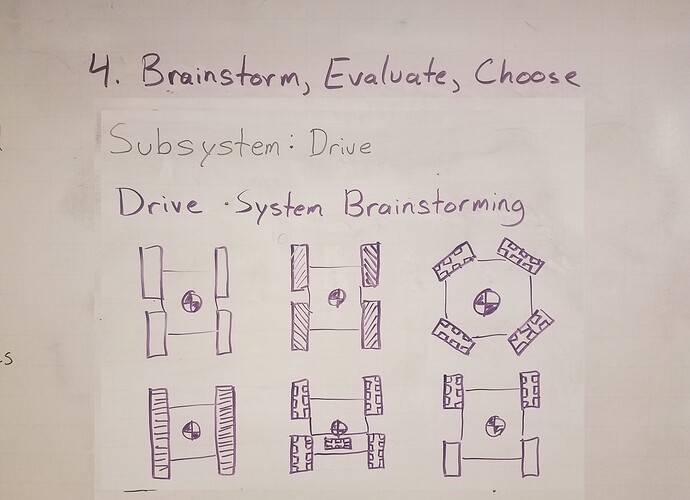

Example of part of the design process attached.
Some notes, for achieving the “best” design for you.
  1. Be objective. Try to find numerical metrics of the “goodness” of each feature you consider to be important. In instances where no truly objective number can be assigned, try to be as unbiased as possible when assigning value.
  2. Don’t twist data to provide the result you want. You can make numbers say anything you want, especially if you are the one making them up. For example, if you have already built a mecanum drive and you are tweaking how important certain things are to make sure that mecanum comes out on top.
  3. Fail often and fail quickly, and learn from it. This can be structured experiments in the classroom, or it can be competitions. Test everything repeatedly, and collect meaningful data.
  4. Be honest. Don’t throw blame, try to find the root cause of your problems, and then work that into your design process.
