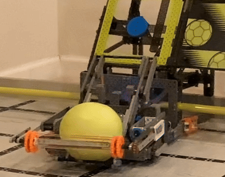

On many ratchet bots, such as the hero bot, the ratchet will take about 3 seconds to reload, versus this speed of a choo choo: (About 1.5 Seconds). As you may know already, in a vex iq match, every second counts.
Choo Choo: (1.5 secs)
IMG_1610
Ratchet: (About 3 Secs)
My Movie 3
The herobot wasn’t my example, top bots were. The herobot uses a 2 motor 1:1 ratchet which is not designed with the same efficiency as a well designed choo-choo. However for better comparison look to a 4 motor PTO bot, something that a choo-choo mechanism can almost not be apart of due to its weight/spacial demands. Ratchets are just as good if not BETTER in every aspect this year and almost every high performing team uses it. The only top teams I haven’t seen use it run a 2 motor drive with a 1 motor t-fling and 3 motor intake but at that point a 3 motor PTO is just more worth it imo and it gives you a 3 motor drive so it also increases drive speed.
