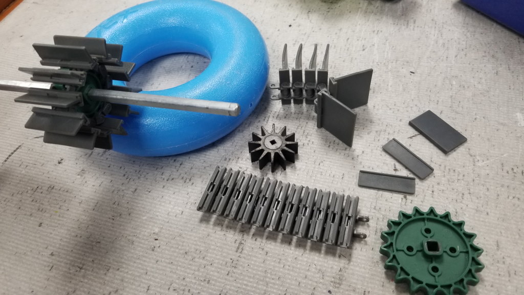

Maybe try an Apollo 13 improv style using what you do have. Here I have sprockets, some tank tread chain and flaps, and an axle. Brainstorm. Prototype, Test, Document results. Repeat.

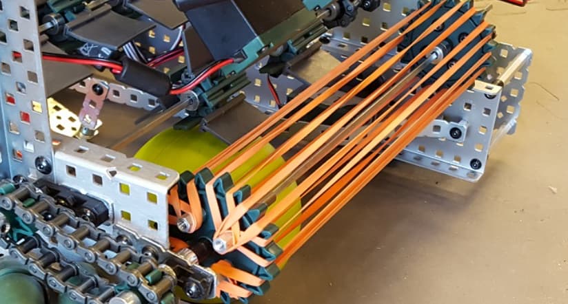

you could use two sprockets that have rubber bands running across from each other and that seems to work pretty well

I’ve seen how doing the rubber band and sprocket method works about as well as using flex wheels for the intake
flex wheels are better though because they have more grip but if you don’t have them then use rubber bands and sroketse

Depends on the intake type, but most competitive intakes will have two stages, a lower intake and an upper intake, which is usually a hook or a hood. The lower intake uses the small flex wheels, but if you don’t have any you can use the sprocket + rubber bands method from before flex wheels existed. You can find examples of this by searching for robots before 2022.

Building off my previous post, heres an image of the mechanism I was talking about.
My team did a similar intake for our early season Over-Under bot and it works pretty well. One of the only problems was the rubber bands snapped a lot.
Can you send a picture of that intake?
Too add to this, the rubber bands will loose some of their grip as you use them.
you should be able to download the picture…

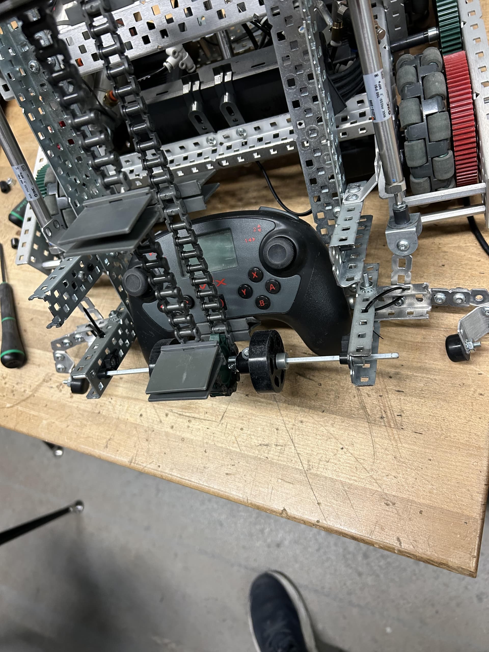

Our intake uses flex wheels, some tank tread chains and plastic carrot shaped flaps.
