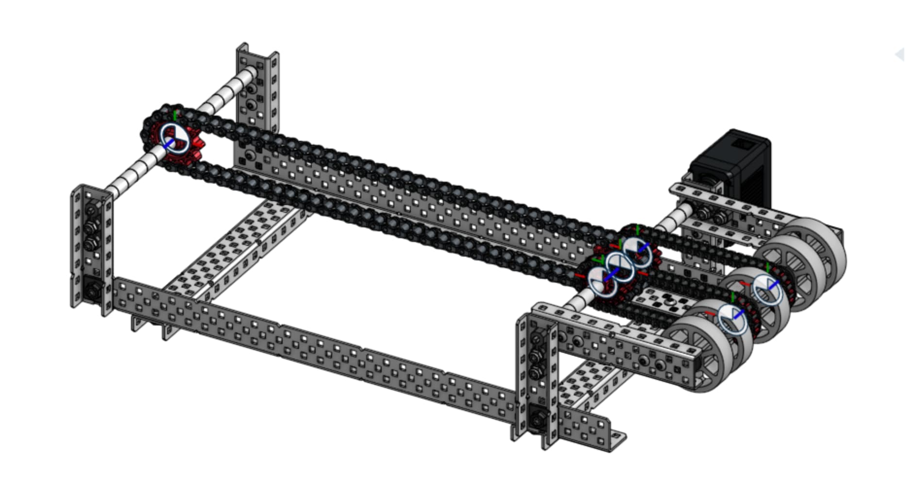

What's your opinon?
I just want some critique on how my intakes looks so far.
Picture:
Made in Onshape btw :ok_hand:
You just might want to clarify a little bit. If you are putting this in your notebook, you should make sure that you accurately explain it. I can understand what you are trying to make, because I have seen similar designs before, but it may not be as clear as it could be
Ok, ill try to :ok_hand:
20 charrr
the first stage of intake looks pretty solid, but I would recommend adding something to pull the rings up instead of relying on friction from chain.
If there is only one screw here, then this will be a joint, not immobilized.
Same goes for the following. The chain might help stop this though.
You should also want a bar at the bottom connected the two sides to prevent rings from falling off, unless that is the perfect area for a ring or something similar.
Make sure this part doesn’t get into the way of rings:
I tried looking for flippers in Onshape but there was none, so I’ll eventually add em. Just not on the CAD

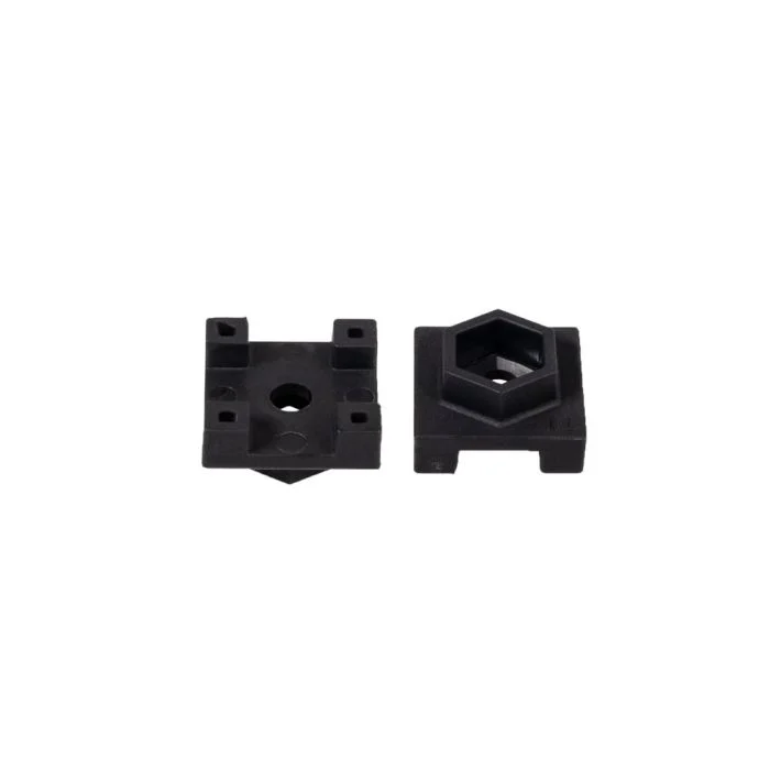

This piece has some posts that go through the corner holes to align them:
They work good to align the holes, but aren’t as sturdy as I prefer.
I would use 2 shoulder screws instead of this.
