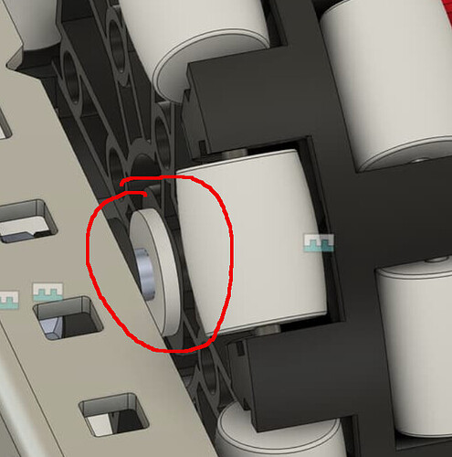

I’m currently cadding my drivetrain, but the wheel’s shaft insert creates a tiny space in between that’s about 0.07 inches wide. Anyone else having this problem? Should I just ignore it?
You should just ignore it because lots of cad software do the same thing also in real life it won’t do it it not like your building the physical bot the cad is just to help invision it will get its message across

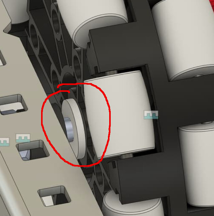

Do you mean this gap?
Well, that’s not a CAD problem, that’s a wobbly wheel problem.
On the real robot, the tolerances might stack in different ways and you don’t want the wheel too tight, but 0.07" is quite a lot of play, perhaps enough to get the omni rollers hit the C-channel.

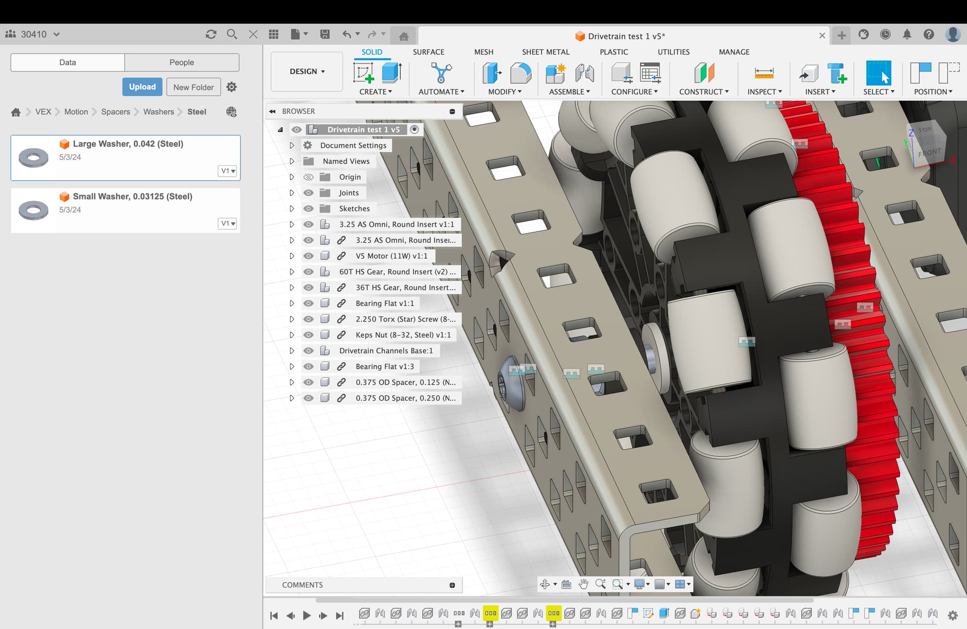

On a real robot, you’d likely use a teflon washer in that space. You can drop one such in the CAD as well and leave the rest of the space empty.
But on a real robot, you wouldn’t use those plastic inserts over a screw, as they are way usually too tight. You’d rather use the the brass inserts (276-8034) and then your spacing would be somewhat different (likely 1/8").
