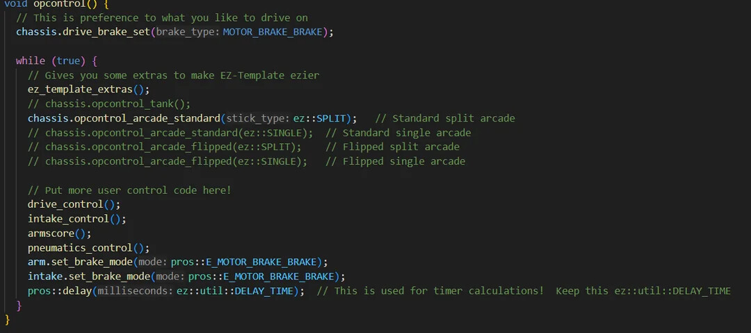

When left stick push forwards and backwards bot go left and right but when right stick pushed left and right bot go forwards and backwards
I’m using ez template vex pros. I’m gonna upload screenshots of our code relating to driving. this issue occurred very recently and it was working even last week
maybe check your irl wiring on your brain
