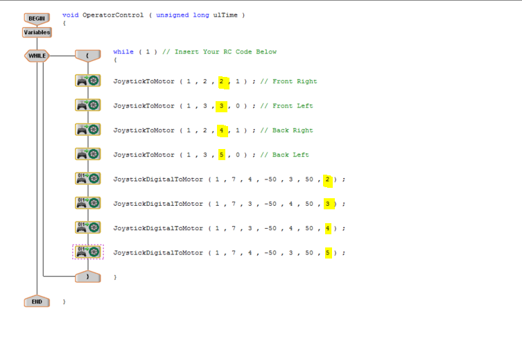

When using digital joystick imput motors are not moving normally
When I use this code (see attached) the motors start and stop rapidly and do not spin correctly (I have tried changing the motor spin values but that does not fix the problem)
The motors are powering mechanism wheels that are driving the robot. Some have a 1 to 1 gear ratio

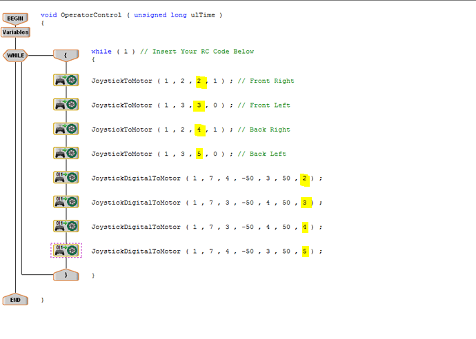

Is this code in your while loop? Maybe you could post an image with more of your code?

It looks like you are assigning values to the motors twice. The first group sets values based on the joysticks and then the second group sets values based on the Group 7 button collection so they cancel each other out. (That is, unless you hold the joystick and press the corresponding button at the same time.)

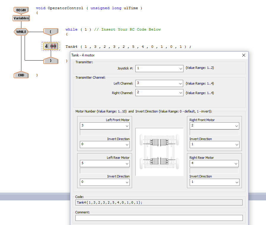

It looks like you are using tank drive so you could replace all of your code with one function: Tank - 4 motor.pasted_image.png
Would I be able to still use digital joystick? I am using a mechanism wheel set and need the triggers to move it sideways

You can use the Holonomic function then. Here is a link
