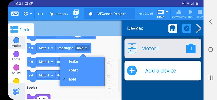

Opps, Now I just saw my title, I think something is wrong with VexIq blocks. I downloaded a driver controll on my robot and when ever I click the up button it goes up but when you leave the button it goes down. When I tryed with robot c it did not have the same problem
It sounds like you need holding mode on that motor. Depending on the mechanism, you may need rubber banding as 2well.
I do not get it, so there is a holding mode avavible on VexIq blocks
Screenshot_20200901-163144_IQ Blocks
Oh ok Thanks 20000000
