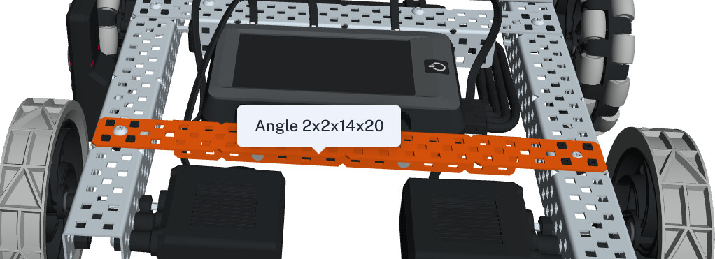

I’m a classroom teacher and we are in need of more of a specific part that I can’t find on the VEX shop. I could use more of the 2x2x14x20 angle beams that are used in the V5 Speedbot, as well as many other builds.
I know it’s possible to just cut regular angle beams to accomplish the same thing, but I don’t have a bunch that are 2x2x20 and I would prefer to reduce the waste that would result from cutting longer pieces.
So, does anyone know of a place where you can buy that specific piece (or just 2x2x20x20 angle beams, since I don’t see those on the VEX shop either).

what do you mean 2x2x14x20. that would be how you describe the dimensions a 4th dimensional object which I don’t think you can buy anywhere. If you need 2x2x14 your only choice is to cut down longer ones. if you are actually trying to buy 2x2x14x20 angle beams I would recommend visiting the fourth dimension as they might have ones you can cut down to size.
I don’t like those pieces you are referring to for the speedbot build. I would recommend using A20, regular angled pieces, rotating them, and bolting them down as the crossbars for the 2 different sides of the drive. In fact, 2 A20’s facing each other makes a great little place to put the brain and makes a good place to attach the battery as well.
The reason I don’t like those pieces referred to in the OP is they are not great at providing structural support, which is their purpose in the build. They bend too easy.
Presumably this:
