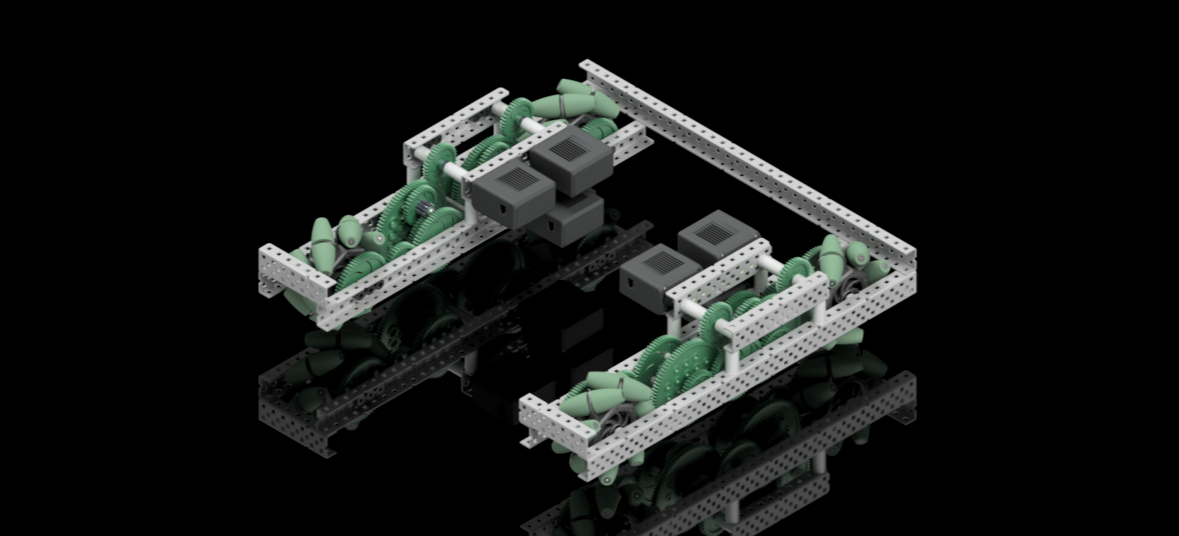

Here is one of my cads for one of these transmissions. I’m assuming you’re doing something similar for a nonshifting transmission, and if you aren’t you probably should be.
It is wrong to say you can’t use a multispeed transmission on a holonomic drive, but it’s decently viable if you’re already doing a similar transmission.
Here is a cad of a 6m multispeed holonomic, and its movement profile. The third motor on each pod loses one direct component of movement (of longitudinal, lateral, turning). In this case it is strafing, but it could also be turning or strafing depending on which differentials you link. A 5m drive would lose 2.
Now this drive may certainly be very impractical, but it is certainly more practical than wasting friction and time on a transmission just to throw your traction away, when applying more force and lower speeds is the whole point of a transmission.
