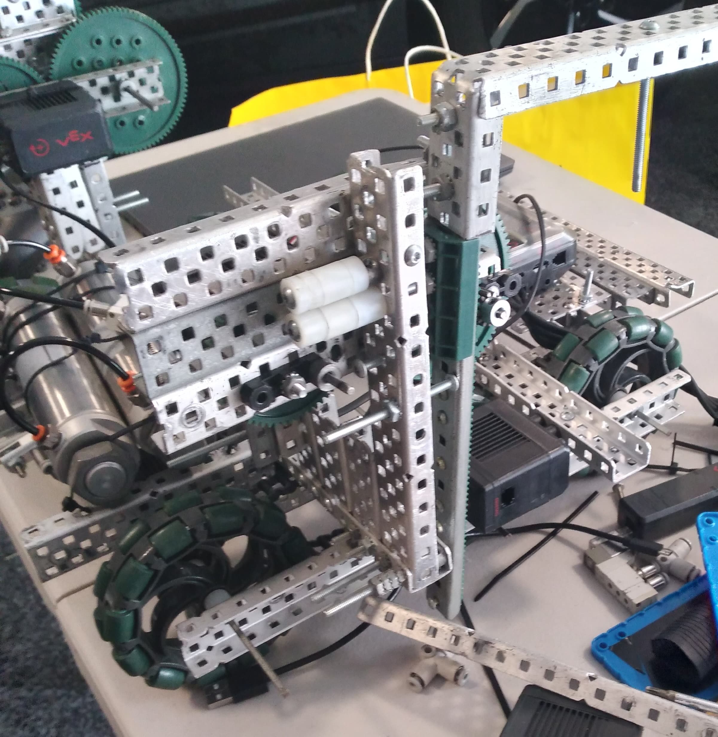

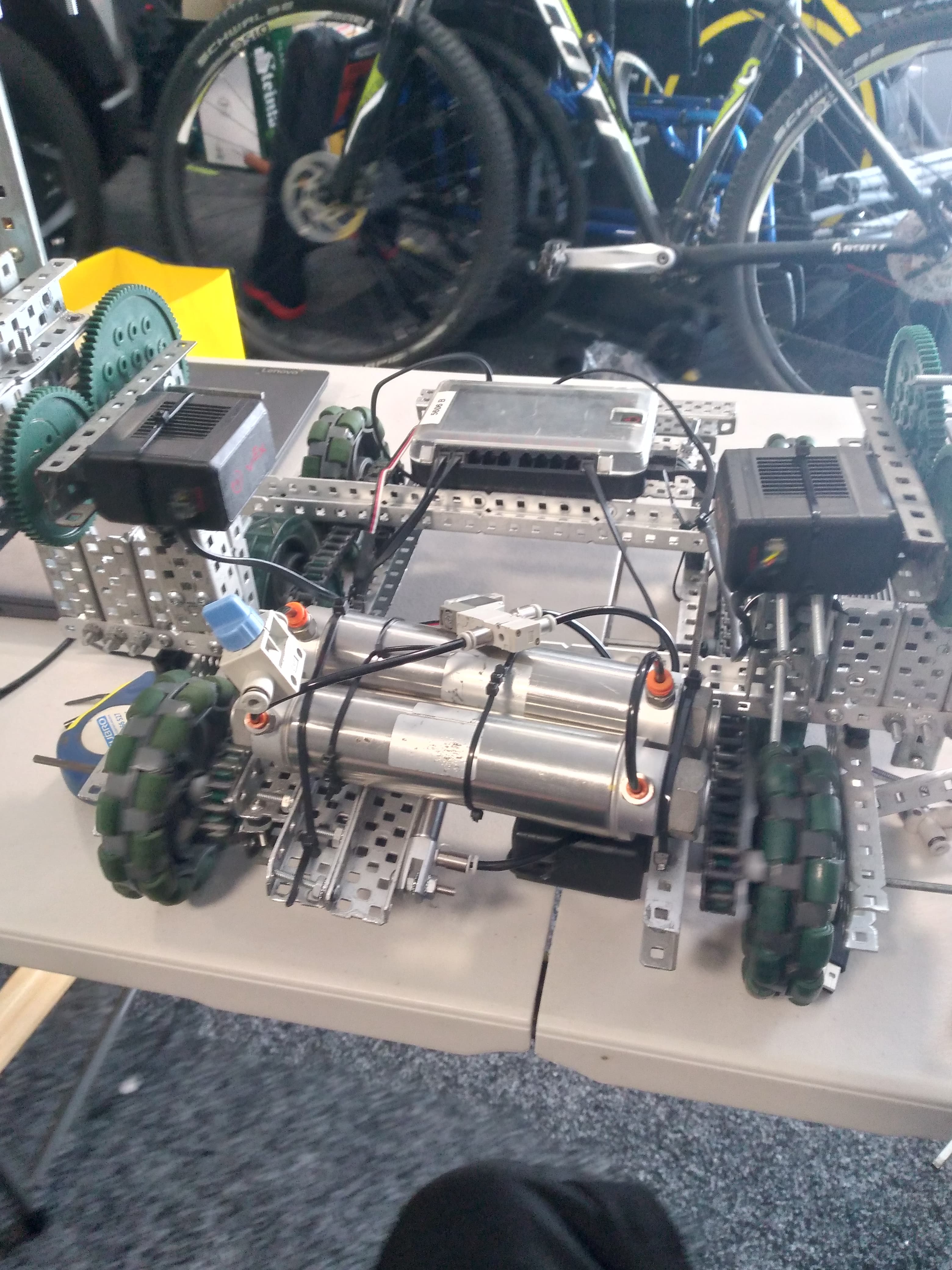

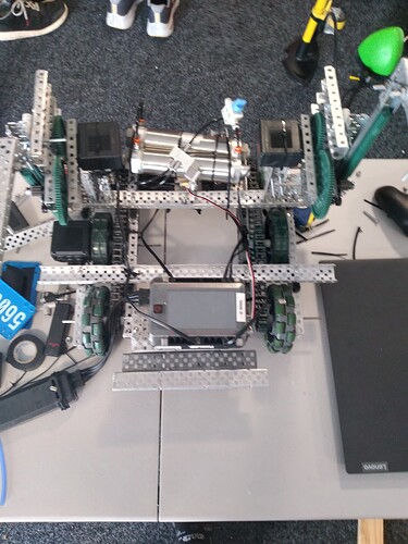

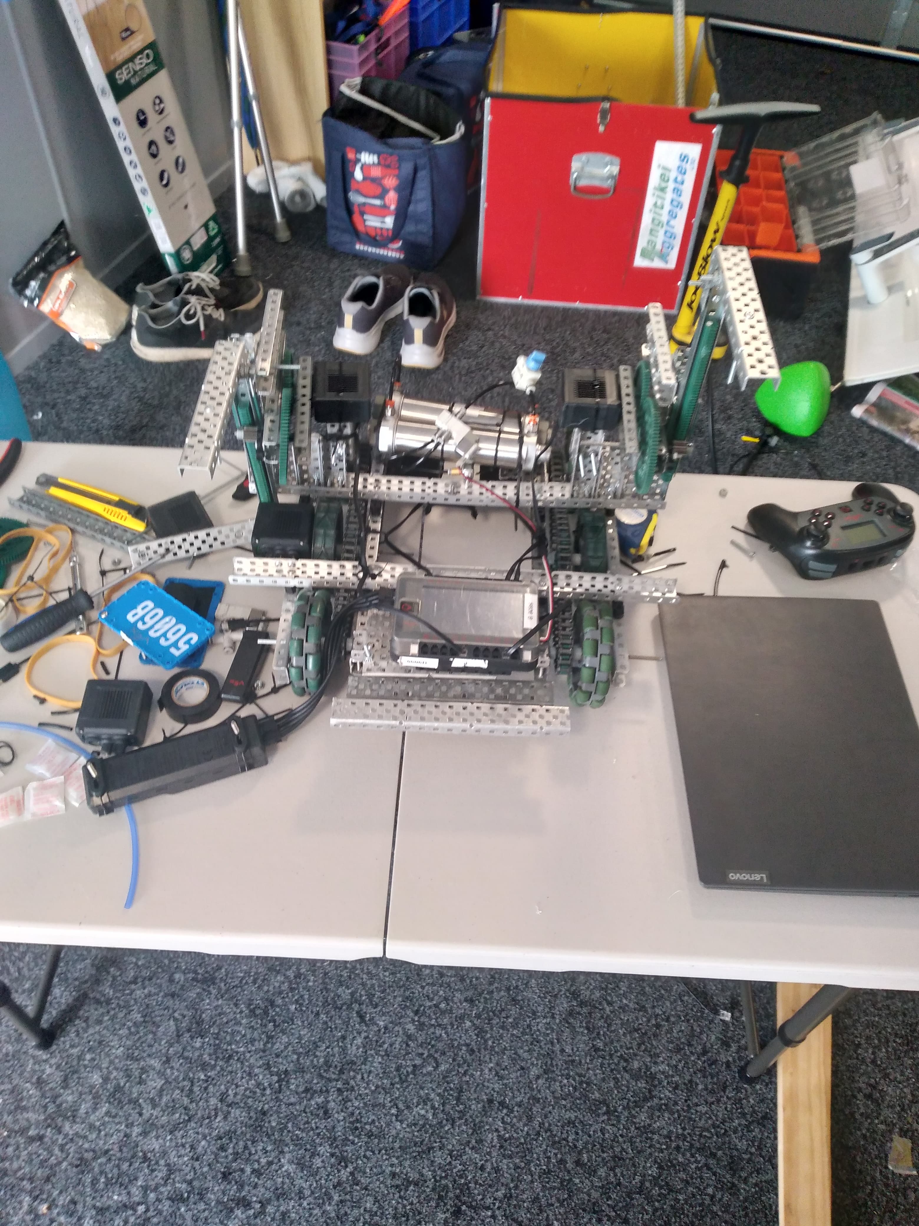

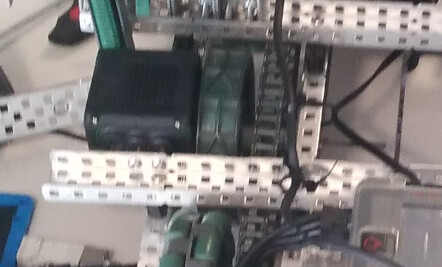

Where would you add moterised wings i carnt figure it out ive tried nearly everything. And no they carnt be pneumatic controlled wings. Many thanks all help is much appreciated

Hi thanks for the replys yes ive seen those and i know how to make them, i just have no idea where to put them on here.

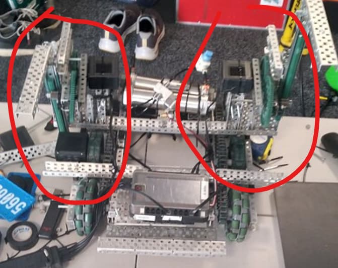

First of all, I would ignore the wings and focus on bracing your drivetrain and make it worlds-worthy. A reliable drivetrain is more important than having wings and launchers combined. After that, build a reliable intake, then focus on wings. Don’t try to build a shooter, much less an elevated one, before you have a worlds-worthy drivetrain, intake, and wings in that order.
  1. Use bearing flats
  2. Don’t be afraid to cut shafts to length, having them stick out will invite rammers to “accidentally” ram off a wheel
  3. Use at least 55w of motors on your drivetrain.
  4. What is this motor for?
  5. Move these two mechs towards the center of your robot
  6. Extend the drivetrain c-channels past your front and back wheels by 3 holes at least if possible.
But to answer your question, I would put them on the front corners of your robot. If they’re horizontal wings, put them on the outermost c-channel on each corner. If they’re vertical, I’d mount them here: somewhere
Right so number 1 i dont have bearing flats also find i dont need them
2. Yes im going to cut the shafts but want to insure everything is ready first.
3. I only ever use 2 motor driverrain many reasons was on another theead a while back.
4. Ignore that that was for somthing i had on before ive removed it now.
5. If i move it forward the mech doesent work properly.
6. If i do that i carnt get over the middle black bar.
7. I carnt add them at the front because the tribal launches through that area see below photo.
Also im not building an intake as thats not what i want my bot to do.
The drivetrain works fine what makes you think it doesn’t.
Many thanks

Just surfing through your last message you might want to consider an intake. If you can figure out wings then you don’t need one but if you don’t its a must if you want to be competitive
Another thing I just realized is that you have a 2 motor drivetrain. I would REALLY suggest at least a 4 motor. Some teams are using 8 motor drivetrains this year (What I’m saying is that drivetrain power is super important)
I know about the power but 2 is plenty it drives fine.
If you’re using this for VRC, imagine your 2 motor drive like a human running while the other 6 motor drives as stampeding buffalo. You ain’t gonna win
If you’re doing skills, 2 motor drives are fine as long as they don’t overheat (seeing as those motors are direct drive)
I would not say plenty. Its ultimately your choice but to be even semi competitive 4 is the minimum. What are you using the other 6 motors for?
