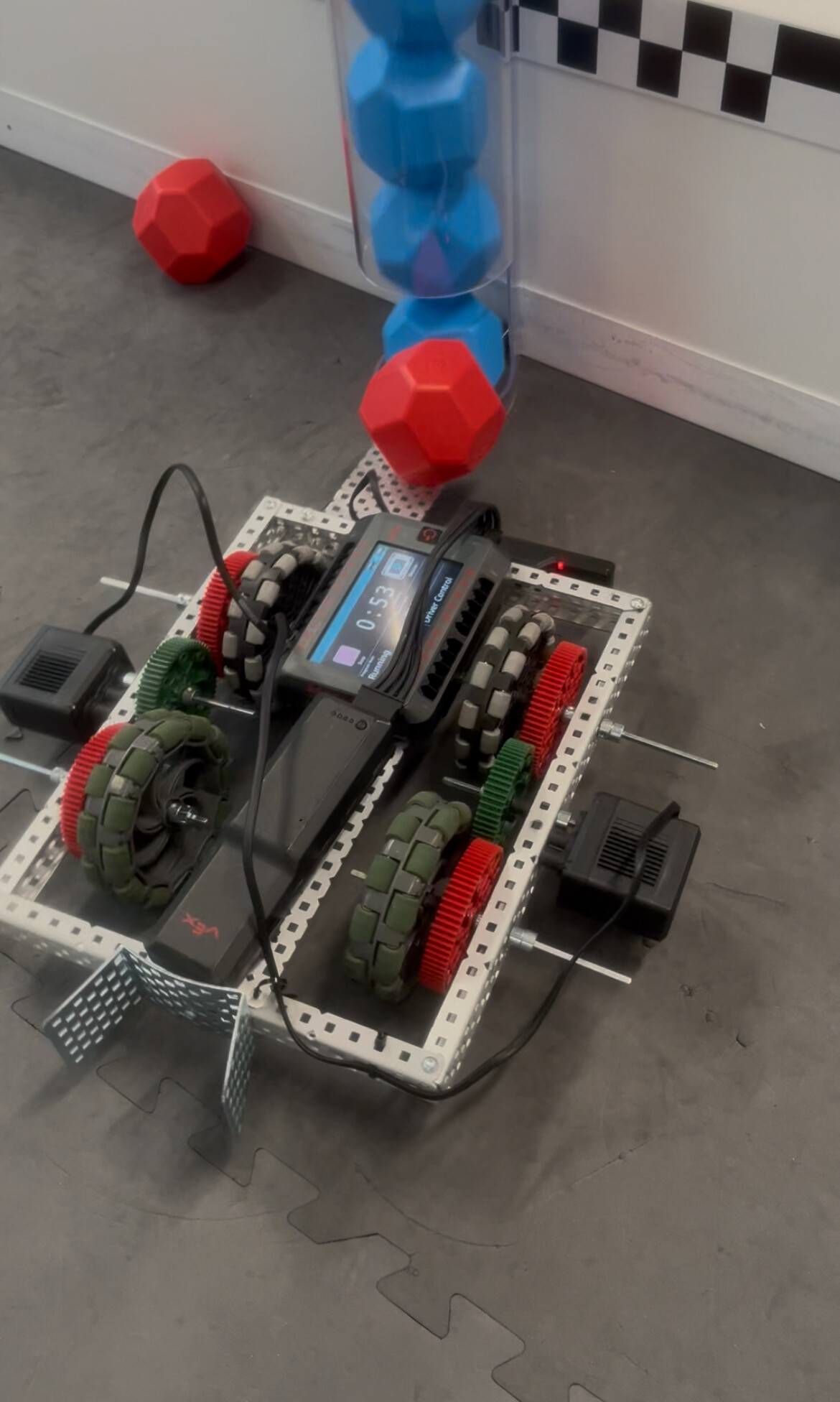

2 motor summer camp build is meta?
i would recommend putting the motors on the inside.
Great work! Just to nitpick a little bit a problem I notice is that your shaft collars are doubled up on the outside, for future reference you really only need 1 shaft collar per axle.
Also did 2 motors work well from your testing? It seems like it might be able to save weight to improve acceleration.
Yes, the robot excelled at competition because of its light weight. Because of this, it could park very easily and it would be able to maneuver around very smoothly. The reason we are using 2 shaft collars is because after experience, the team figured out that if the collars were sandwiched, they wheels wouldn’t get out of balance.
