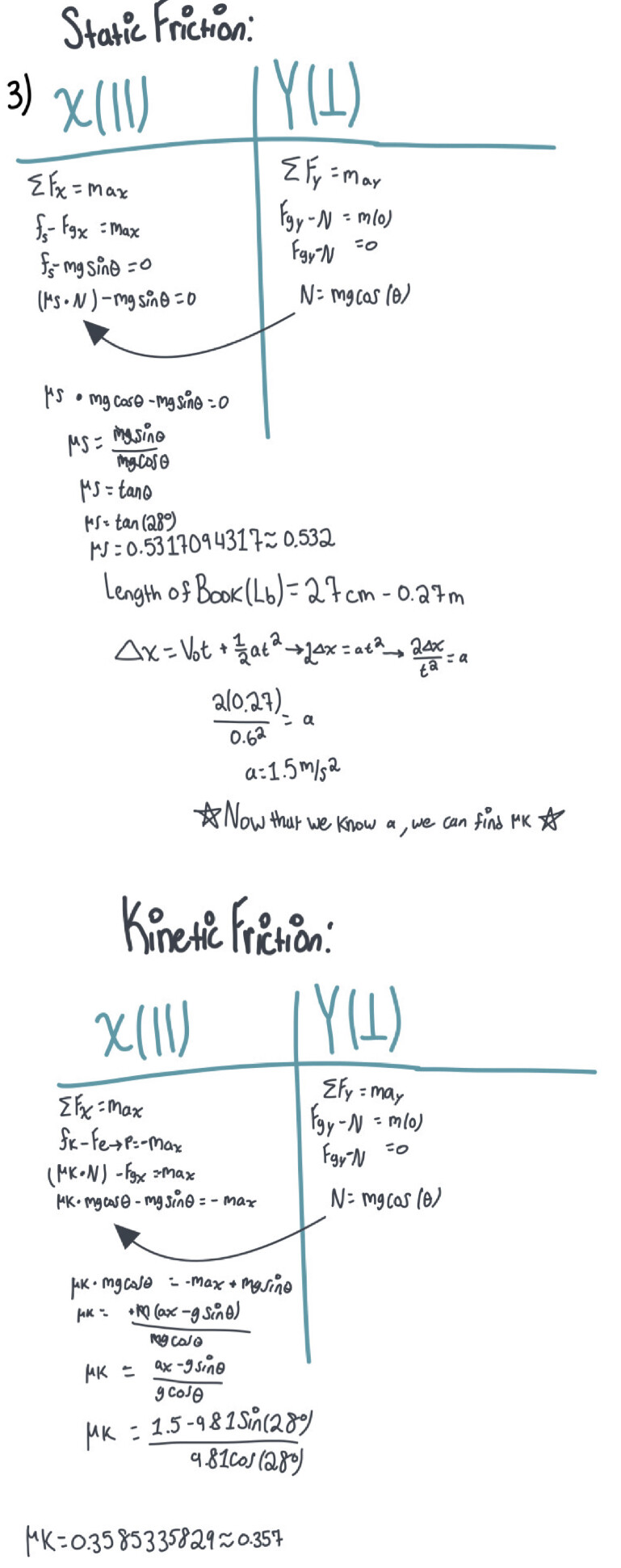

Here is my work for a similar problem I had in AP Physics I last year. While the problem is different than what you described, the work should be similar to what needs to be done to solve your problem.
