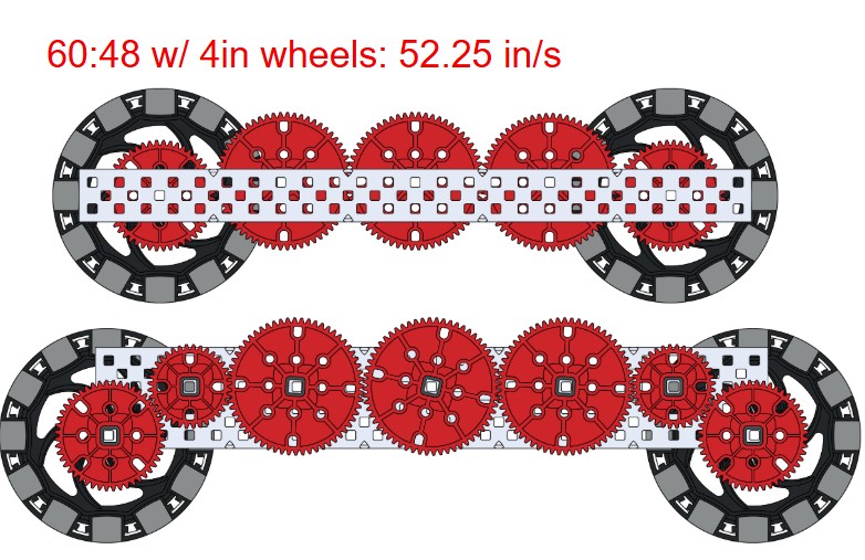

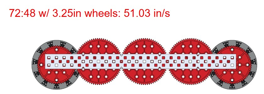

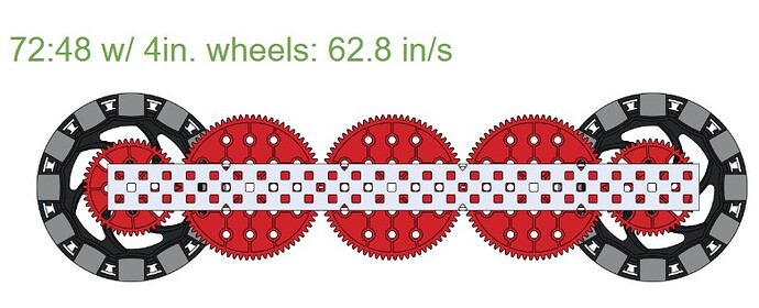

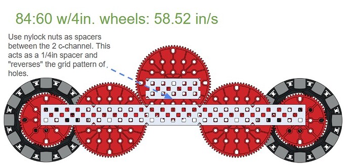

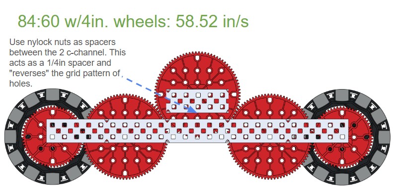

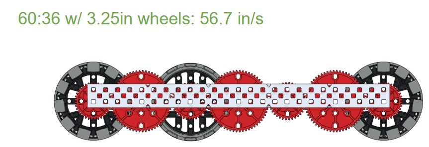

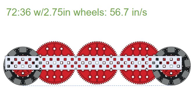

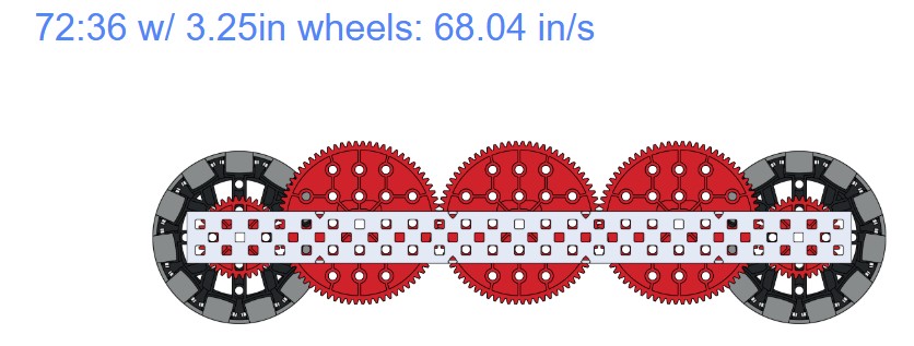

ok, I’ll see if I can get our coach to buy more aluminum then. also, here are the drivetrain models I made:
There are better ways to make some of these with longer c-channel, but we dont have that, so I compressed some of the longer gearings by using stacked c-channel instead.
