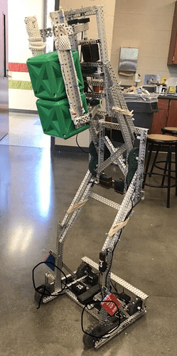

example
Ignore the circles, but all of the motors on our first robot this season were ziptied. You do two zipties, a little bit aways from each other, and loop them through the C-Channel. Make sure to use long and kind of thick zipties, but still thin enough to fit through the channel holes. Also make sure to tighten them until you can’t even slip a piece of paper through the loop. We didn’t tighten ours enough so they ended up being a bit useless for us. (Pliers work well for tightening them a couple more clicks.)
Also, for all things holy, never use two small thin zipties, connect them together so they’ll be the right length, then slap them on.

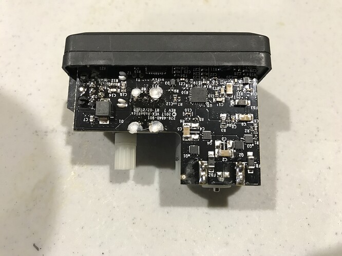

Why take off the bulk of the motor when you could just replace the back electronics section?

So for heat swaps would taking off only the back part work the same way?
could you elaborate on back part?
If I’m thinking what I think you mean, then that would be disassembly of the motor and would be illegal since all the electronic components are located back there
Yes that’s correct. Taking out the cartridge of the motor doesn’t really help too much. The main reason is to actually replace the housing (back part) of the motor!
For the back part motor, he is talking about the part of the motor in which you place your motor cartridge in. This contains all the actual motor and other parts. The cartridge (red, blue, or green) is placed in this “back part”. It is not disassembly of the motor, you are just taking the motor (without a cartridge) and replacing it with a new one! Hopefully this makes sense.
There is no rule prohibiting the disassembly of vex electronics, as long as they have not been modified.
Last year many of the electronics I competed with had been disassembled, as documented in this thread
The specific assembly I was talking about swapping is this:
