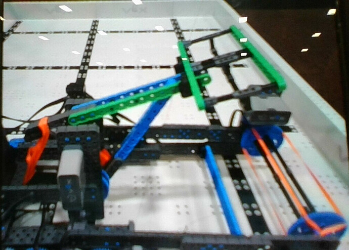

to be honest i feel that a conveyer system as displayed by caution tape alpha could be a better design overall i just feel that a catapult although fast can have bigger consistency problems as the rubber bands will wear out so you would have to change your rubber band frequently and if you have to change rubber bands multiple times through the competition the place were you launch from might change between an old worn out set of bands to a fresh new stiffer set. so my only real complaint about the catapult is potential for inconsistency although it does seem that many teams are having great success with it.
Can I see a picture of the conveyer system please
When it comes to getting balls, a roller intake is one of the most efficient designs. It’s also probably the easiest to make. So, simplicity and efficiency. Hence why you see it on all the robots. Heck, it’s even on Fling!
Here is their early season reveal VEX IQ Pitching In Conveyor Concept Design by 839Z - YouTube
The main reason I am not for the conveyor method is because from my experience in building it, it doesn’t work well. It was slow, inconsistent, and clunky. Also I’ve built several catapults, and if you store the robot with the catapult up, the rubber bands will last for a few weeks before needing replacing. So you don’t need to worry about replacing them during a competition. My answer isn’t the one all be all, but it’s just my take on it.
