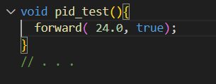

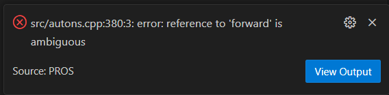

Why does it keep saying that forward is ambiguous in PROS?
I am new to PROS, so I have encountered many issues but one I could not figure out how to solve was why the error message kept saying that forward was too ambiguous.
It is ambigoud because “forward” has been used in PROS before iirc. You would need to change the function name “forward” to something like “pid_foward”
