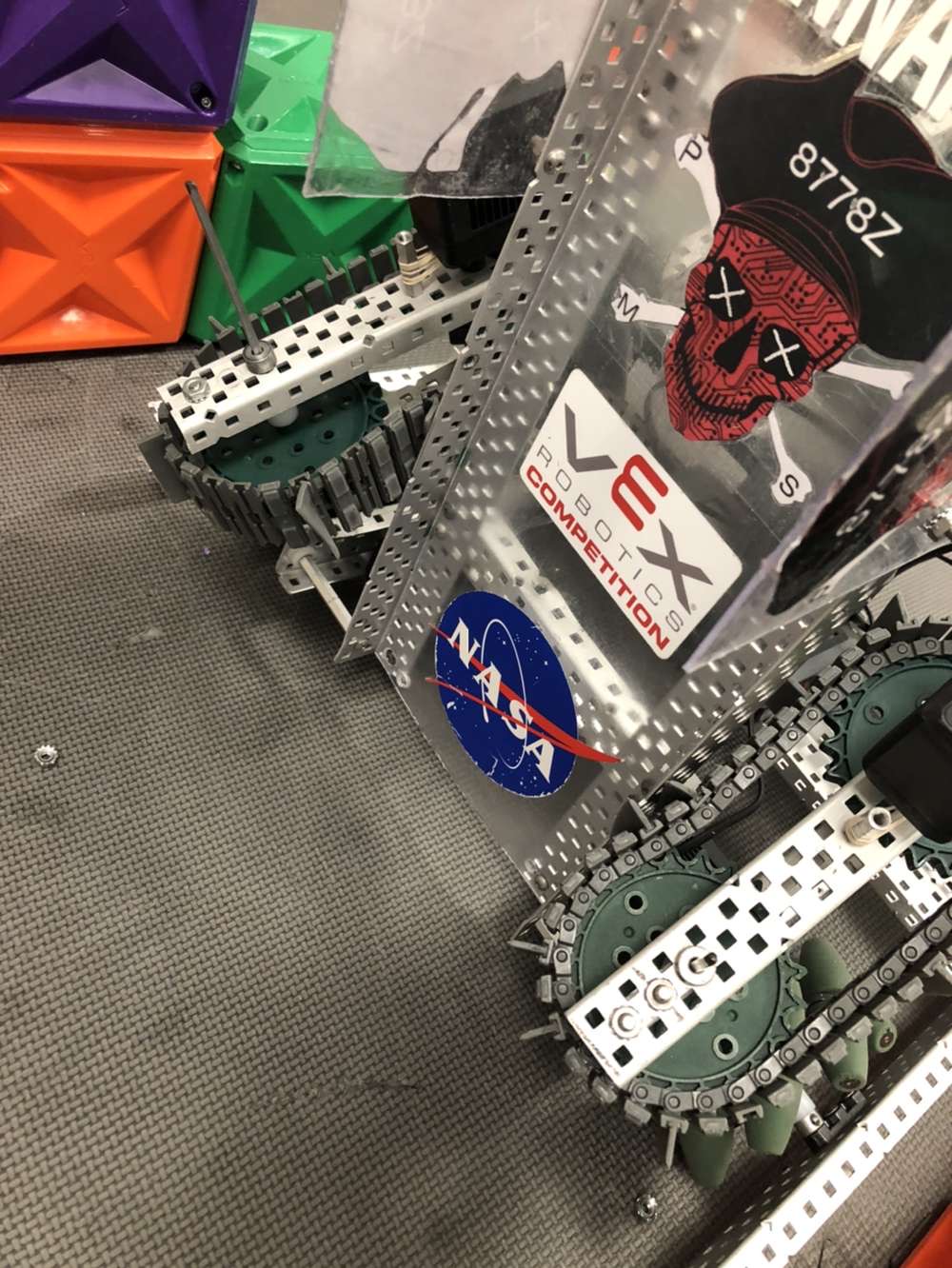

Do you mean not using two sprockets connected by flaps and rubber chain?
Sorry just found an image of my old intakes to see if this is what you mean. And yes the lift was up when I took the picture.
Intake from here, we can see how the OP mentions how the front roller runs faster.
We can also see how the higher torque in the back roller helps with fielding balls in the wall goals, and now I think I get what you meant by pulling the ball through the wall goals.
I guess I should have read the field spec more carefully. Now I see why chinatakes are still viable.
