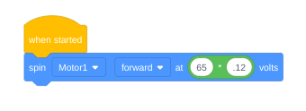

Volts spin the motor directly without a built in middleman (automatic built in pid), and as such are usually more consistent for flywheel applications. (Noticeable in a lack of oscillation sometimes caused by using rpm and velocity control on flywheels) They spin the motor using a voltage value ranging from 12 volts to -12, -12 being backwards from whatever direction you chose. If you want to convert velocity to voltage directly without doing any math just multiply the velocity by 0.12:
See image.

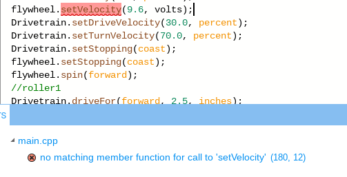

After checking the docs, you can see that setVelocity doesn’t accept volts as a unit. You need to use motor.spin, like this:
Motor.spin(forward, 12, volts);
Still doesn’t work
I put it in wrong on my response, it’s volt and not volts.
