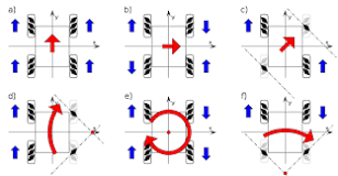

here is some resources for making them
how to code them

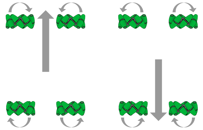

make sure they are in a x pattern otherwise they wont work or it will rotate as it strafes
here is what it looks like in a x pattern

now here is the wrong way btw they should be in a X looking from the top
wrong way below
