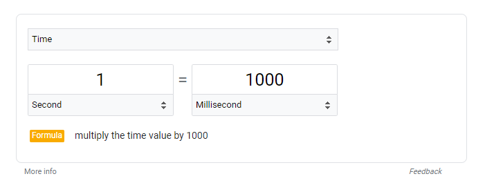

There is one thing though…I cant remember what unit the time value is in, I believe telling it to sleep for 2000 is 20 seconds if I’m not mistaken. Don’t quote me on that since I use a value of 1 for my while loops and I don’t really use anything higher.
Pretty sure it’s milliseconds.
He should be good on that.
